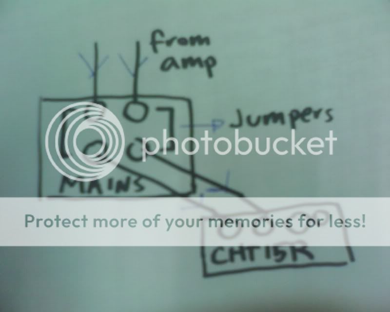

mike c
mike c
for a stereo setup - with stereo subs:
my amps are behind me and i want to add stereo subs.
can I do the following, instead of wiring a new set of speaker wires running from the amp to the subs?
speaker wire from amps - to main speaker - to speaker level inputs on the subwoofer (CHT15R)
any cons on doing this?
