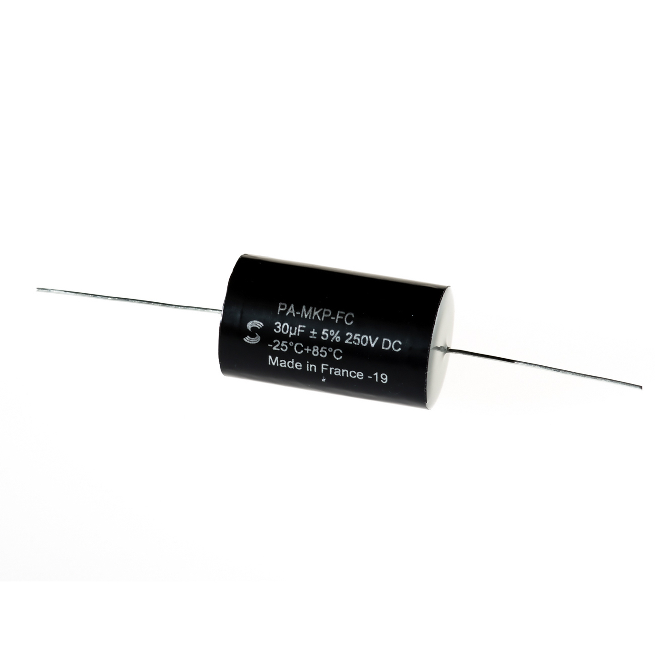

Here is an example with a Solen polypropylene cap that is very affordable. It is 250 volt rated. Their 400v ones are slightly more costly but still reasonable in price. As a matter of fact, TLS Guy as well as I use them. Solen is a Canadian manufacturer of quality caps and air core inductors. That firm is renowned worldwide. Parts Express and Madisound Audio sell their products:
