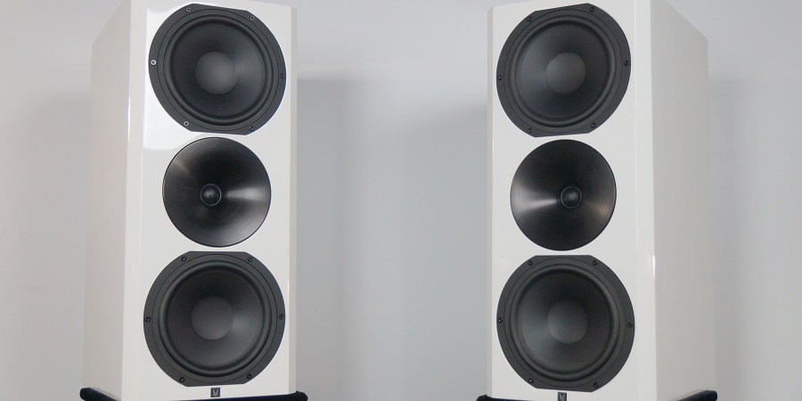

Over the past few years, Arendal Sound has been building a reputation as a loudspeaker manufacturer that makes high-performance but affordable home theater-centered speakers. They are a Norwegian company whose main market is Europe, but they ship worldwide, and they are set up to be easily purchased and shipped across the globe. They make THX-certified speakers that look nice enough to not be out of place in an upscale living room. Many of the speakers that have that level of performance married to that level of looks tend to cost a fortune. Arendal’s loudspeakers are not the least expensive out there, but they are shockingly low-priced considering what they promise to bring to the table. But the keyword there is ‘promise’ - it all seems to be too good to be true. In today’s review of Arendal’s 1723 Monitors, we look at what the ‘catch’ is or if there is a ‘catch.’ Read our full review of the 1723 Monitors to see if they are al they are purported to be...

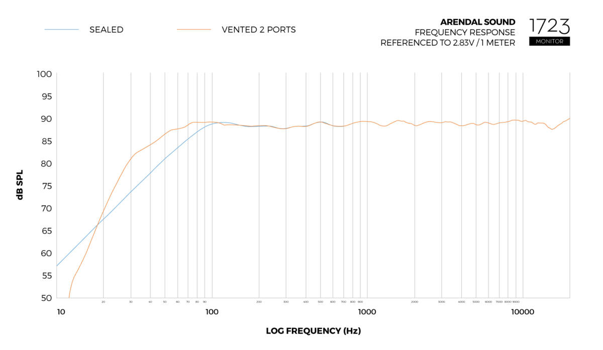

Speakers that show that kind of rise between 2 and 5K I tend to find objectionable. In my experience a rise in output in that region is a far greater sin then a dip. That is a very bad region to have any degree of rise in output. That really affects strings, brass and especially massed choirs. If they were my speakers, I'm pretty sure I would be padding the tweeters down at least 2 db more.
The other issue is, that I have never been at all keen on speakers with a 1.5 K crossover. I find that about the worst place to put a crossover in the whole acoustic spectrum. It is right in the middle of the speech discrimination where the ears is most sensitive to the slightest aberrations. Your data shows this is far from the finest implemented crossover.
I would be really dubious if those speakers would be keepers for me.
I would advise members not to purchase these speakers without a really good return policy. I have pretty high degree of certainty, many are not going to be happy with those speakers.
As for the rise between 2k to 5k, that only occurs on-axis. There is no elevated treble off-axis, and the response at 15-degrees is very flat. Of course, you could further reduce the treble response by listening to it at 20-degrees or further. Most people don't listen to speakers that are aimed directly at the listening position.
As for the crossover, I think it is pretty good. You do see some indications of the crossover point on a graph, but it is slight, and I doubt anyone would be able to hear it. My guess is that you would not hear anything amiss in a blind test. If you have a chance, you should give these speakers a listen with an open mind. They are terrific.

Arendal's own measurements show a relatively flat response, though I wish they included horizontal lines for reference.
The graph posted by Eppie looks better from an FR standpoint. However your waterfall plot shows significant discontinuity right at crossover. That stands out even more in your in your polar map. Now unless you can use very low order crossovers there will be discontinuity at crossover, mainly due to time aberrations. I personally avoid designs with crossovers in that really sensitive 1k to 2.5 K range if possible. I just find they are prone to getting noticed. I suspect the rise in FR is due to what is basically a horn loaded tweeter, that you can call a wave guide if you like. But to be honest that is a horn loaded tweeter and getting rid of that hump is very difficult. It is reminiscent of the FR of the Dynaudio D21 tweeter.
