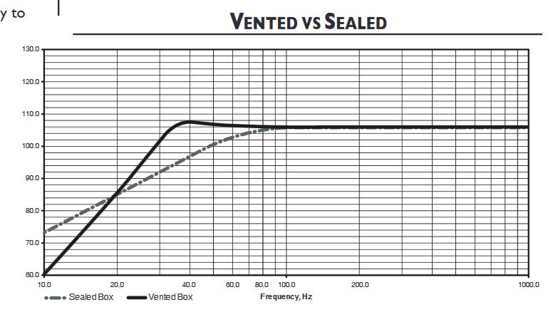

In this review at 24:30 James Larson said running the 1723 Tower S in sealed mode would lose half the headroom. What does that mean? Does it lose 1/2 the total SPL the speaker is capable of?
OTOH is there a benefit to running them sealed?
Running the speakers in sealed mode would greatly reduce the headroom, but only for the deepest frequency range of the speaker. Porting a speaker can increase its output by two to four times - but only for a narrow frequency range in lower bass. However, lower bass is the toughest range for a loudspeaker is handle, so any help there is very advantageous.
I'm still learning. Is saying they'd lose output by two to four times is equivalent to saying they would lose 3 db - 6 db in the bass range?
Could be as much as 6 to 12dB. Here is a very simple example of a ported vs sealed response:
