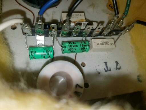

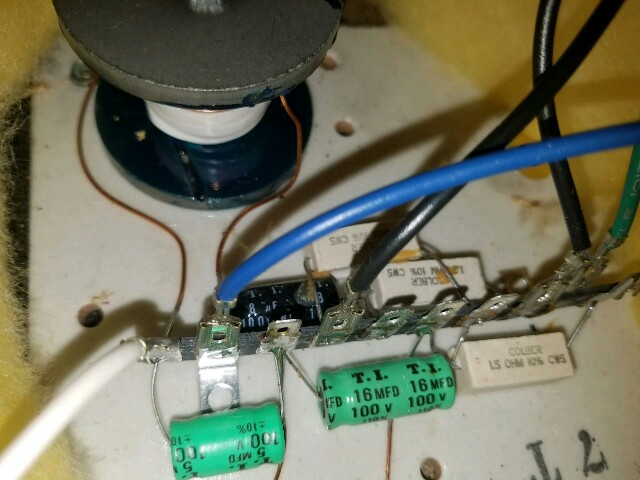

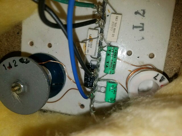

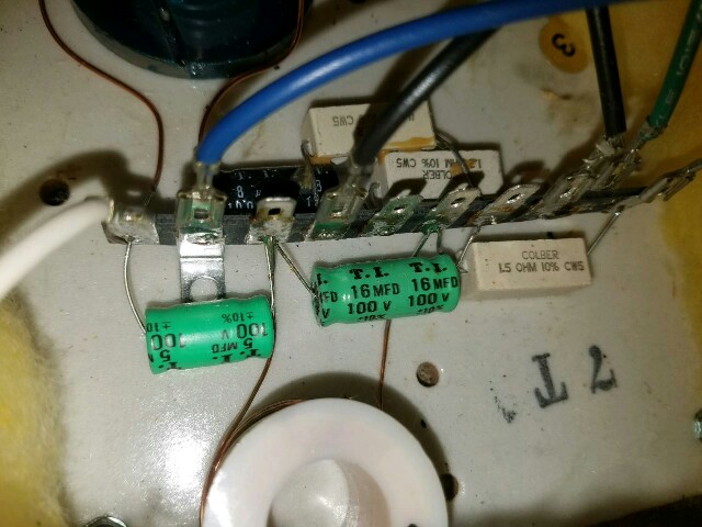

I believe it's one of those. It's not straight foam. Kind of like the surrounds on my Hsus. While I had it apart I took a few pics of the crossover inside the cabinet and wasn't overly impressed. I don't know diddley about crossovers tho, so for all I know they're better than they look.
View attachment 31032View attachment 31033View attachment 31034View attachment 31035
I can wiggle my phone in there for some better pics if anyone wants to see them. There's lots of stuffing in these cabinets, that's for sure. The front baffle is 1 3/4" thick, with the woofers recessed into it 3/4". They're very solid speakers. They weigh over 40 lbs apiece.
That is a real amateur job! Those are low quality non polarizing caps. I would replace those with Solen polypropylene caps. Now you are into DIY you have money to spend on decent quality components. DIY is not really about cheap speakers, but mainly far better ones for the money.
Oh no you didn't! Now I want to replace caps and improve on the crossover!
I thought the same thing when I saw what was inside. I've never put a crossover together before but even I can tell that was poor work. I'm in man. I'm all over improving these speakers. I have some small amount of experience with soldering and am not afraid to tackle a project like this. I can take those crossovers out and take better pics of the components. I'm gonna need some help and guidance but I'm kind of excited to do this.

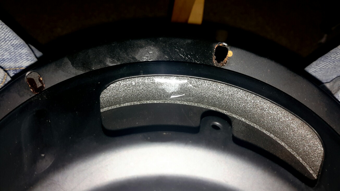

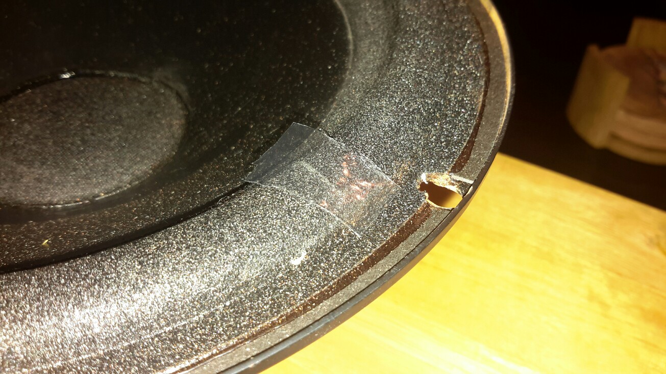

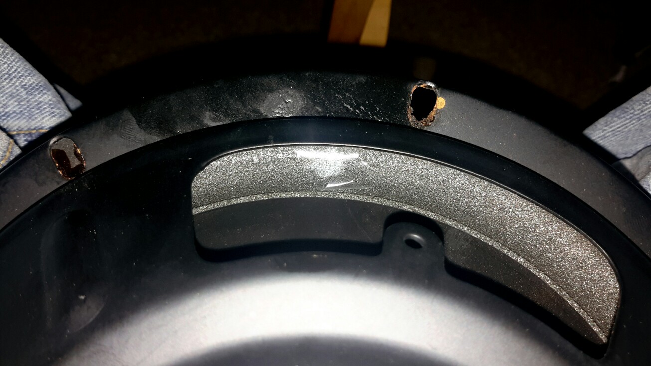

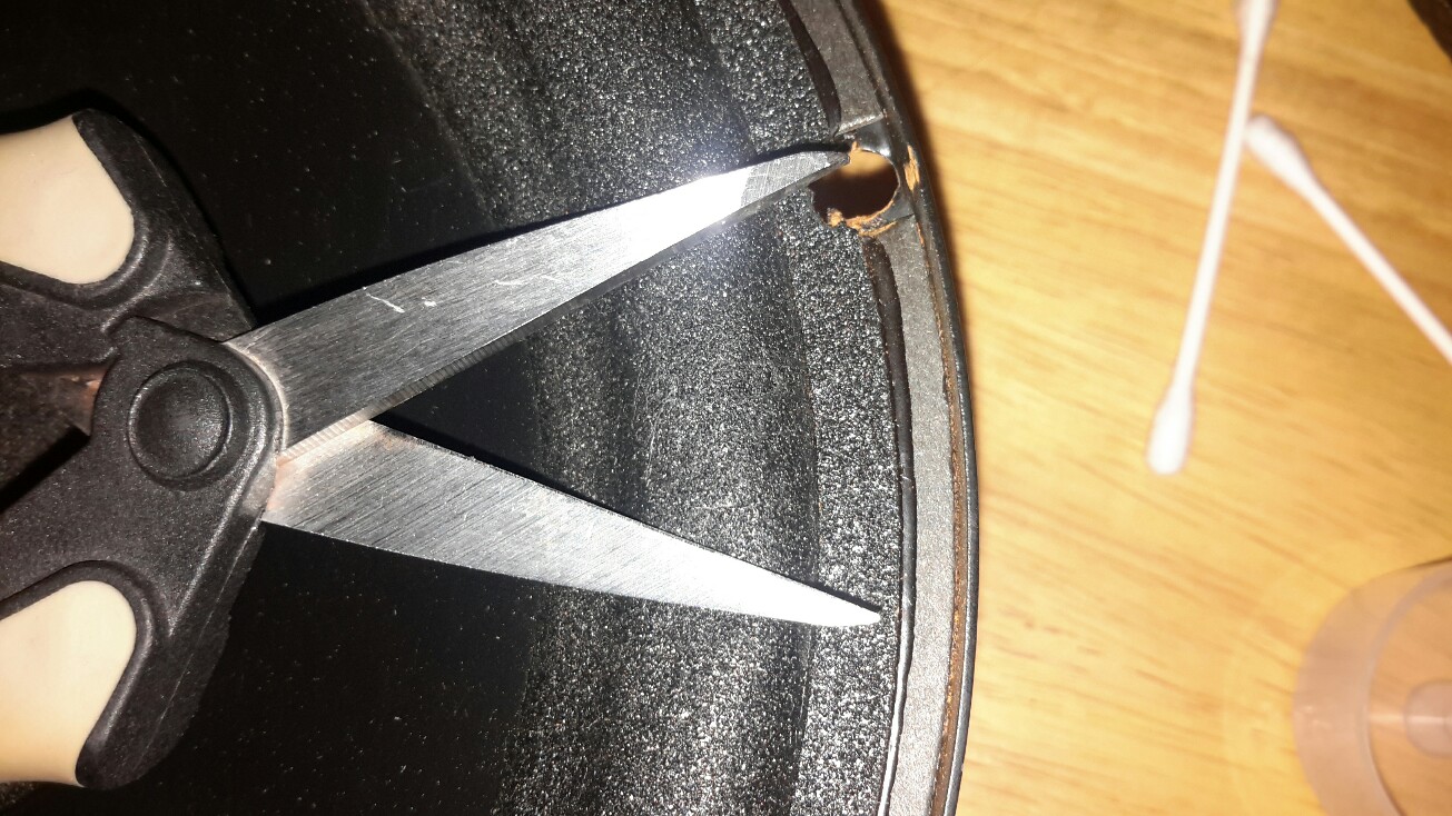

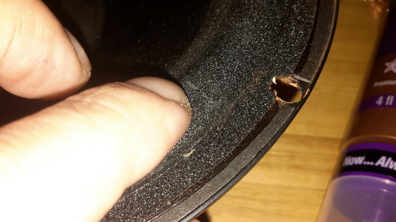

I got the driver yesterday and as shown in the ad, a small tear in the surround. If I were to guess, it looks like it was poked by the screwdriver used to remove it from the cabinet and not due to any kind of rot. Later today I'll put a drop of rubber cement on it and clean the seam with q tips. The glue I'm using is water soluble and dries flexible. I feel like it'll be an easy, indiscernable fix.
Until you showed up and made a post about the crossovers I wasn't even considering doing anything with them. Now that I know there's room for, and that they can be improved I want to give it a try. I'm not that deep into them money-wise at this point so if I royally screw something up its not a big loss. If you don't mind helping me out I'm game. I have no clue where to shop for caps or which ones to get and have never built a crossover before so I'm gonna need the most elementary advice just to get started. I'm confident in my ability to learn tho, and I'm genuinely passionate about the project.
They already sound pretty good (at least the one, I have more parts coming to fix the other). If any major improvements can be made I might even keep them for a 2 ch setup in another room. I already have a spare receiver I can hook them up to. Hell, my wife might even stop thinking I'm an idiot for driving to the next town to buy these ugly ass speakers, lol. Thanks for popping in and offering your observations doc. I'm looking forward to learning some new things.

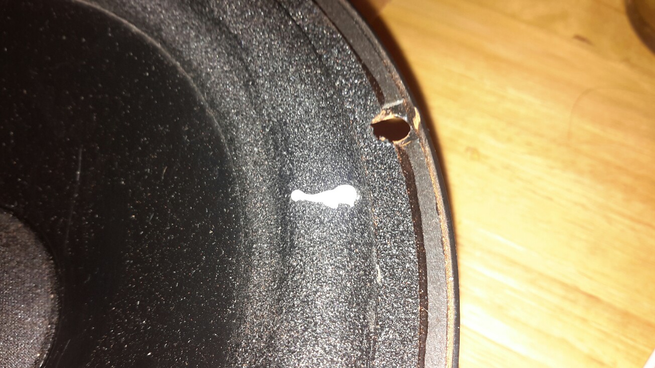

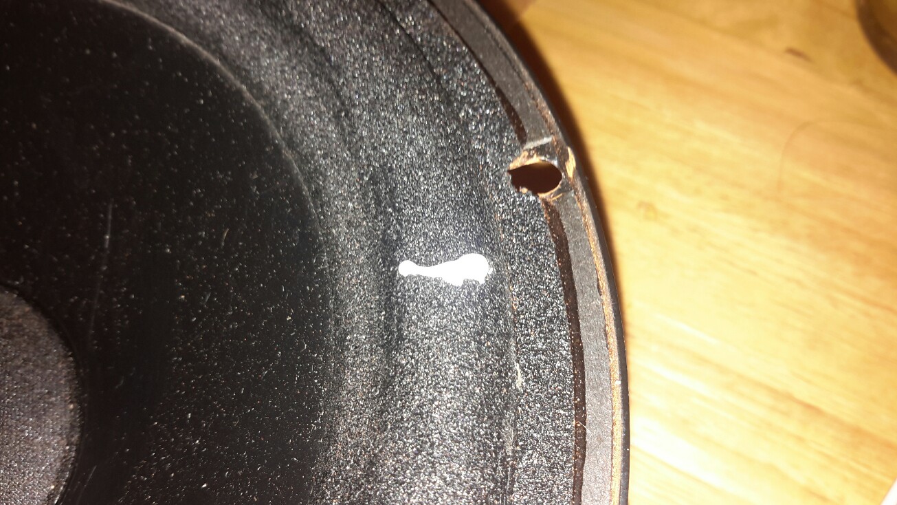

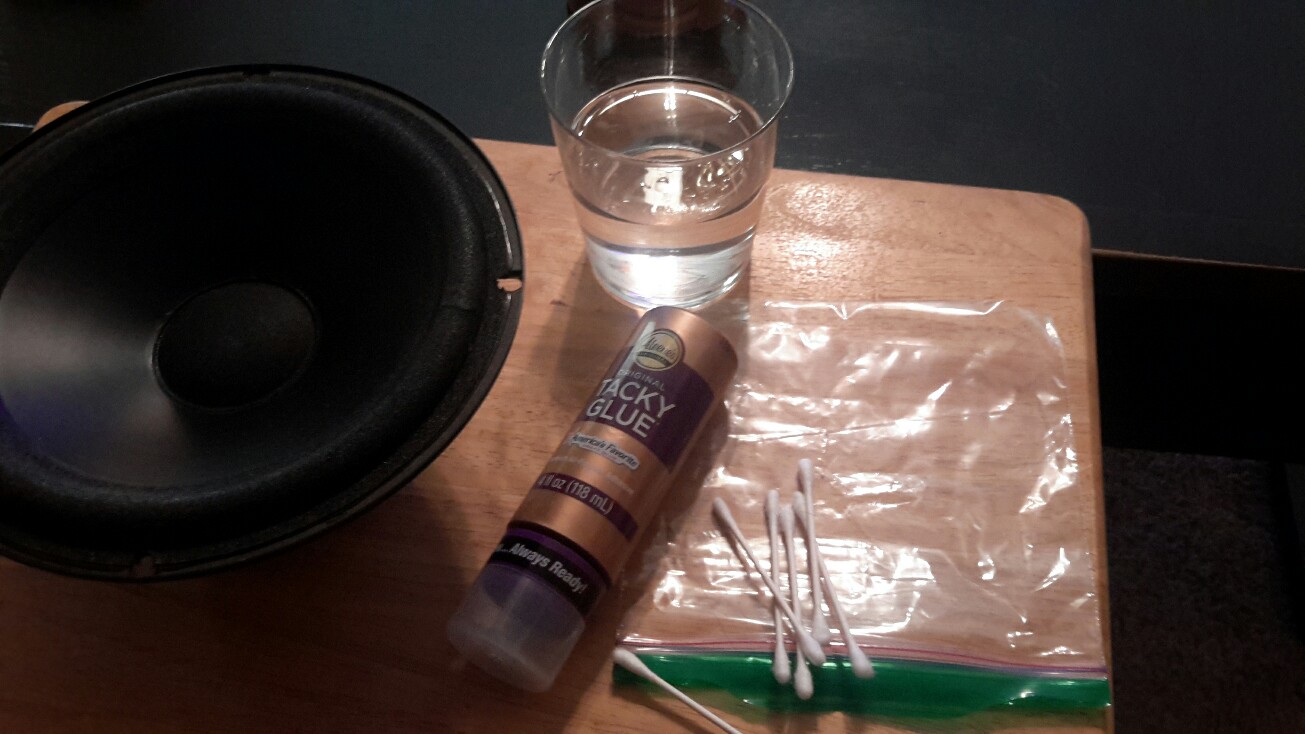

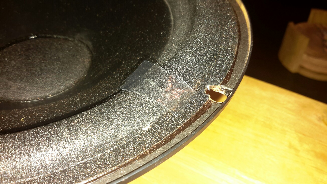

Operation woofer surround.
I made a patch with a piece of sandwich baggie, put a tiny drop of glue (Aleene's Tacky Glue, dries flexible) on it and stuck that on the backside of the surround with a pair of tweezers. Another drop on the outside of the tear, cleaned it up with q tips and now it's almost invisible. It's right in the center between the scissor blades in the pic above. I know where it is and still have trouble finding it. I'm calling this operation a success!

I made a patch with a piece of sandwich baggie, put a tiny drop of glue (Aleene's Tacky Glue, dries flexible) on it and stuck that on the backside of the surround. Another drop on the outside of the tear, cleaned it up with q tips and now it's almost invisible. It's right in the center between the scissor blades in the pic above. I know where it is and still have trouble finding it. I'm calling this operation a success!
Well done. Nice job!

I'll get the one crossover out of the cabinet and take some pics for a better look. I still need to know which caps to order to replace the ones on there and those coils (inductors?) look kind of sloppy to me too.
