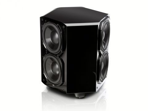

Of course 4 subs are better than one!
Why do you think paradigm put 6 into their sub 1 and sub 2 enclosure

Why do you think paradigm put 6 into their sub 1 and sub 2 enclosure View attachment 32566
Ummm...
That's just 1 Sub.
Sure, it has 6 Drivers... but just 1 Sub. (Ie, Driver colocation does not equal multiple Subs placed in a strategic assymmetrical arrangement in the room in order excite as many Room Modes as possible, thus minimizing as many nulls/cancelations as possible, thereby creating a more even LF performance across the Listening Area.)
Now if Deep Sea could take that and build it with their SI Drivers... I'd settle for the 12" variety... and take 3.

I took my smart ass pill today before that post ;)
It’s a beautiful sub though:)

If I do another DIY subwoofer, it’s gonna be based around this.
