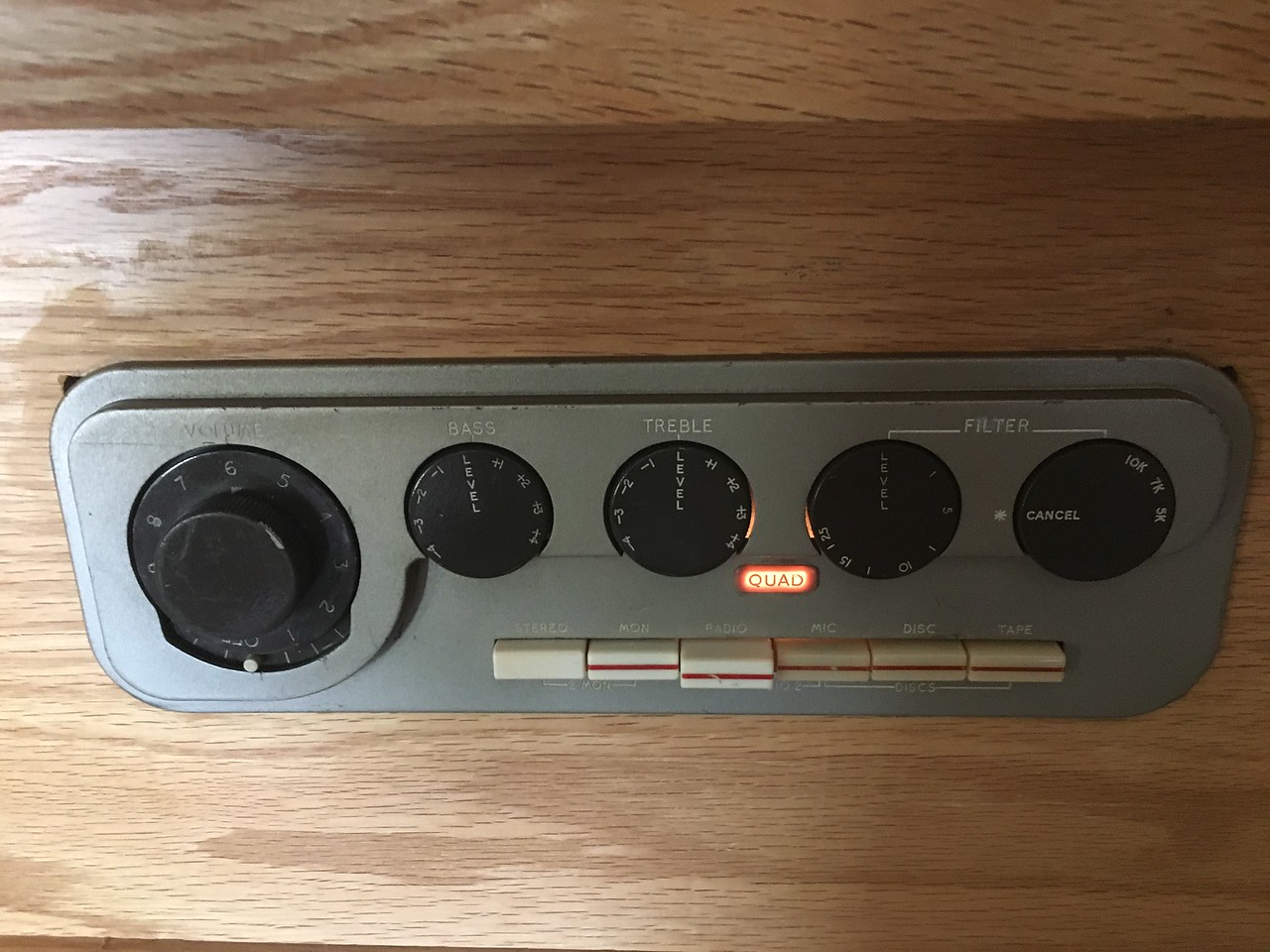

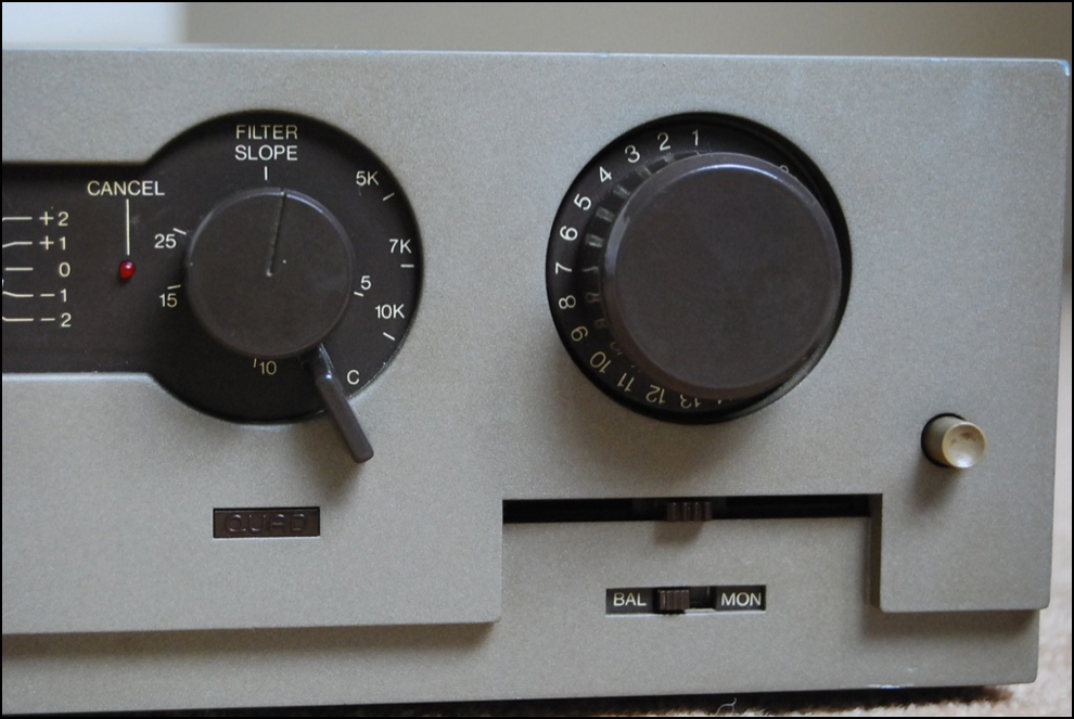

Here is a picture of my Quad 22 I bought in 1966.
The knob far right sets the turnover frequency, and the knob to its left sets the rate of slope, from 1 to 25 db per octave.
Yes, you could do the same with an octave equalizer, but its a lot more bother and requires an extra unit. In practice that arrangement works very well for taming 'edgy' LPs.
This system was preserved right up to the Quad 44.
In the whole stereo era Peter Walker produced four preamps. The Quad 22, 33, 34 and 44. They are all really excellent for LP reproduction.
He got the high pass bass roll off dead right, as you can't really cut an LP without bass roll off at 28 Hz in the disc cutting process. And that warp wow is present on almost all LPs to some degree, and his filter slope stops it, so you don't have woofers doing useless wasteful excursions below 10 Hz. This also causes doppler distortion. His decision and Arcams are right on the money and should be standard practice and isn't.
The Quad 44 allows for precise setting of cartridge sensitivity and most importantly the loading capacitance from tip switches on the top.
I think the Quad 44 gives the finest LP reproduction possible, and in my book is number 1 for LP reproduction.
