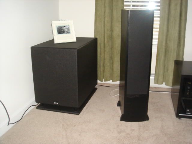

I love my SVS sub. What i noticed the other day is that when i am sitting about 5 feet away from my sub or closer while watching TV or listening to music the thump is just incredible even at low volumes. when i go to my listening position I cant really hear the bass of the sub. when i turn it up during movies obviously the house shakes.
Just seems as though not getting the optimal effect from my listening postion. I have it set up appropriately, all set to small, crossed at 80 in reciever and crossover on sub set to max. All speakers calibrated with SPL to 75 and sub at 78. How can i test to see if the Sub has a dead spot in my room? I have 24X16 room and sub is set in the corner.
I moved the sub to right corner of the room and cleaned up wires since this photo

Based on the description of your situation, it would appear that your listening position is sitting in a null do to excited room modes. The increase bass you hear as you approach the sub and thusly a wall is know as boundary reinforcement. This is a common problem for many people.
The cheapest way to help combat this is the crawling for base method already suggested by bandphan. This is the best you can do without going to more drastic methods.
After crawling for bass your options are acoustical treatments, and EQing.

Try moving the sub to a different location if possible.
i will try but i am pretty limited to left or right corner, otherwise it will be in the middle of the right wall. I will experiment. Are there any test that can be done to confirm that it is in a null.

Without taking mesurements from the listening position, crawl is the easiest. Check the phase to see if it will fill the null. (temporary solution to a room problem)

The way that I checked the frequency response of my sub at different positions was to use a set of test tones (I used a CD from AV123 that cost $5, but you can also download those tones off the internet) and an SPL meter. I measured the output at various frequencies to figure out where my nulls and bumps were located.

The PEQ will be able to tame the peaks but will have no effect on nulls. Same with any other type of active EQ.
Changing the location of the sub or adding bass traps are the most effective way of dealing with nulls.

Unfortunately like others have said you are sitting in a null. Moving the sub may shift the null to another seating position but it will still be a compromise. This is one of the drawbacks of a single sub. Room treatments would be your best solution and/or getting a second sub.
