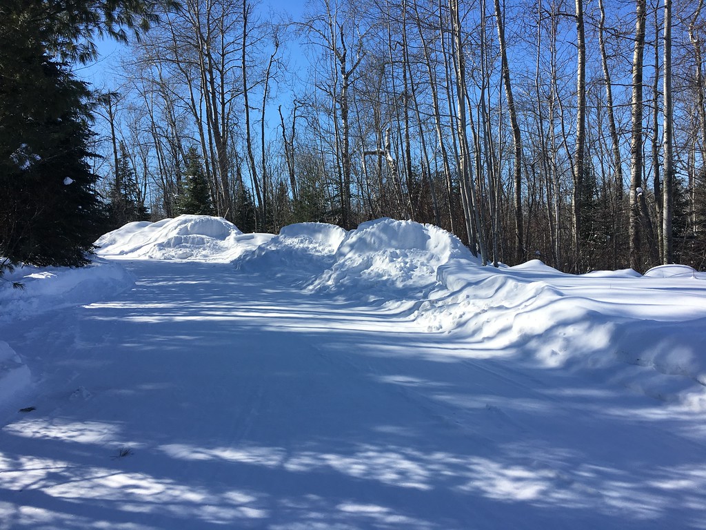

That depends entirely on how it is looked after, the design and reputation of the tractor and if it was a good design in the first place. Some are just dogs from the start.
If you take a JD Waterloo tractor, those are the horizontal two cylinders, with the 180 degree firing cycle, the old timers tell me they never wear out.
I know the history of mine. I was the third owner. The first only had it a few months. The second owners were a family I know well, having looked after three generations at one time or another. I know they were excellent mechanics, and had taken good care of it, despite very hard continuous use over years. That tractor always had normal oil pressure. It used no oil. It stated first piston up, hot or cold. It pulled like an ox, and begged for more. When I sold it at auction it was 71 years old. I looked after it carefully, and it left me at least as good and may be better then when I paid $3,300 for the old girl at auction.
These are the sort of snow banks she would regularly throw up.
And start in the depths of winter, just like mid summer.
So there are no hard and fast rules. I will say if you have a modicum of mechanical sense, a good vintage tractor is one of the best bargains on the planet.
