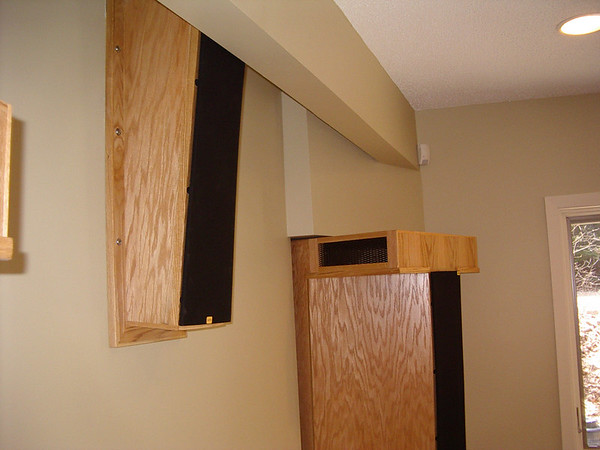

This is the aperiodically damped transmission line I designed for those drivers,

For a center, a TL really comes into its own, because the driver reinforcement is non resonant with a Qt of 0.5. Also the bass roll off is second order, rather than fourth order for a reflex enclosure. Honestly I have never heard a center speaker that comes close to performing like my TL center, no matter what it cost.
The electronic crossover for the fill driver, is first order at 250 Hz. I use modified Shure SR 106 crossover because I have had them lying around for a while, and they have a good quality case.
