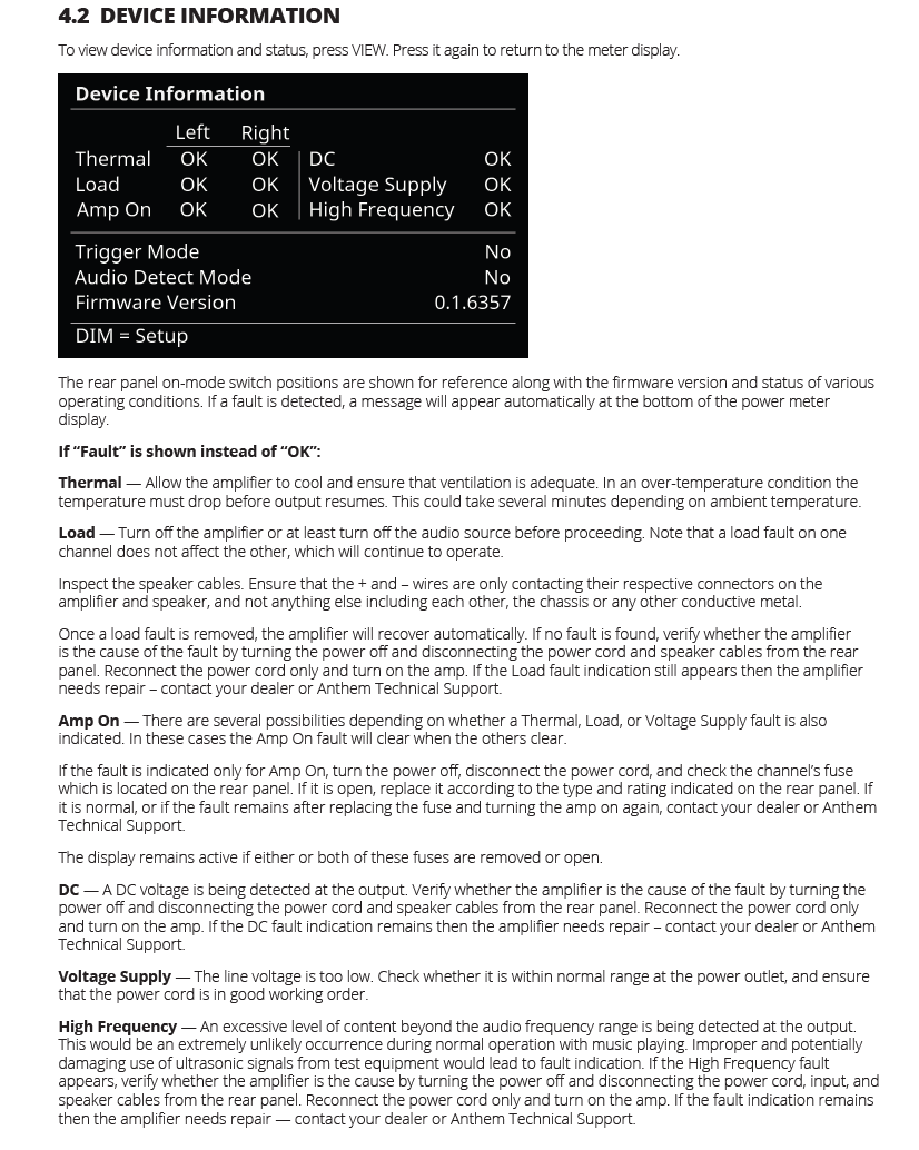

Have you read the owner's manual yet? It could just be blown fuse(s).
Got the STR back, full power supply replacement. Been putting it through it’s paces, seems back to speed but remote trigger now won’t work. Using auto sense instead as I’m not shipping this back to canada again. 62lbs cost me 100 after paying 6k. They did full warranty except not checking all functions as trigger worked fine when I sent it out

That sounds strange that the trigger worked when the amp would not power up. Are you sure about that? I suppose it is just possible they they disconnected the trigger on purpose. They may know something we don't, such as that circuit being involved in the failure, having seen this before. That is a reason manufacturers should always make circuits available.
