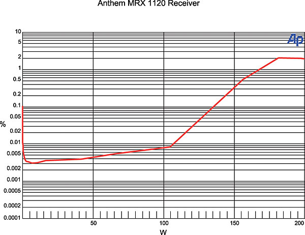

$3500 Anthem MRX 1120:
$2200 Marantz SR-7011:
No, you will not hear the distortion at these low levels, but it seems fair to associate lower distortion with better circuit design and higher quality components/build quality.
The Anthem never gets below 0.003% distortion and climbs to ~0.0045 by 50Watts output.
The Marantz gets down around 0.002% and does not exceed 0.003% as it climbs to 50Watts output.
At 100Watts, the Anthem is at 0.008% distortion and the Marantz is at 0.0045%.
So through the main operational range, the Anthem has 50% (or greater) more distortion than the Marantz.
From the other posts, it seems that the Marantz has more features.
So, saving $1300 gets you better design & build quality and more features!
So the Denon AVR has more power (or at least equal), has great 1 ohms dynamic power, and has less distortion (or least as good) than the Anthem AVR, but somehow some people still insist that the Anthem (and Arcam, NAD, etc.) sounds better. It boggles the mind. :D
Rationale? It's just because. :D
