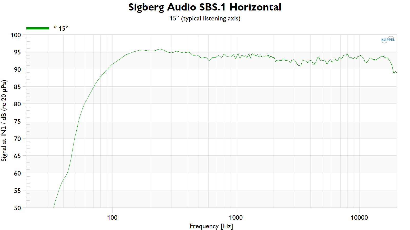

I've now been back to Seas and their Klippel with a revised configuration (closer to the production crossover configuration).
on-axis + 15 degrees (roughly listening axis) first. Both of these are around +/-2,25dB from 100-20,000hz (15 degrees are rolling off a bit at the top end).

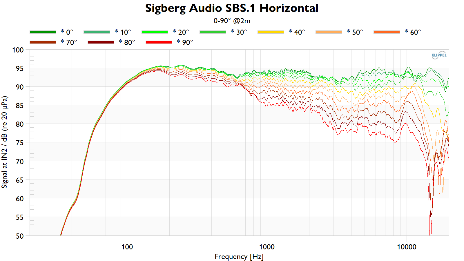

And then 0-90, where it's now more even across the crossover between the midrange and tweeter as opposed to the response shared by @shadyJ :
