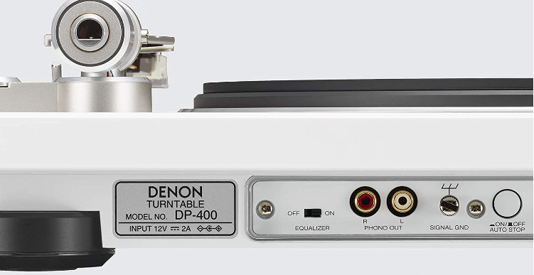

The photo of the rear panel of the Denon DP400, shows a pair of RCA jacks and a switchable phono equalizer. I believe Denon provided a MM pickup with this TT, but did Denon also provide a cable? What length? (Edit: I just read that Denon supplies a 39" RCA cable.) Does Denon also include adequate instructions as to how this cable's length may be longer only if the built-in equalizer is used?
As I have stated before I optimize the loading capacitance of any given cartridge. I suspect this in not factored in in TTs with a built in phono preamp. So there is every possibility that the loading capacitance is too low. This affect is likely to be audible, in that using the TT preamp, rather then the receiver preamp could well result in excess HF and give a harsher sound.
If it isn't factored into the TT's built-in phono pre-amp, why would you expect it to be different with his AVR's phono pre-amp, or an external one?

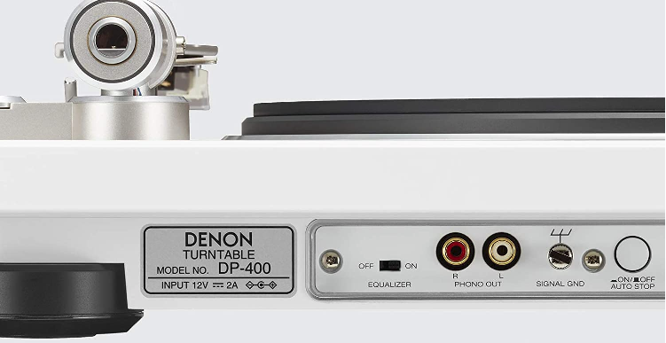

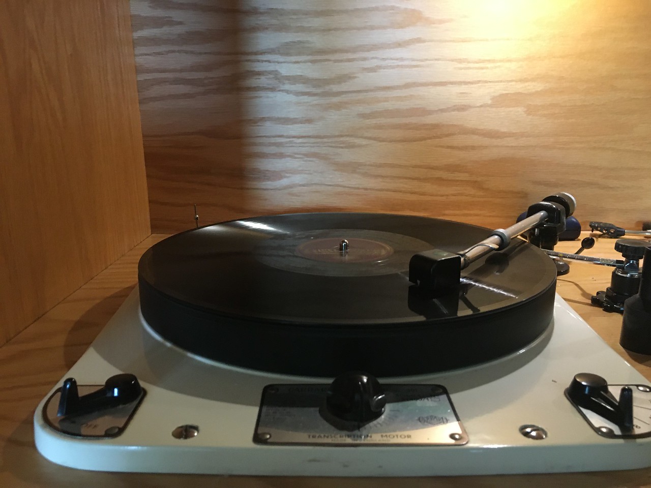

Well, we must be the only ones spinning 78 shellac discs.
This is my studio turntable case.
Left to right:- Garrard 301 with Decca FFSS H4E LP head and MK 11 78 head connected to Quad 22 tube preamp from 1966, recently restored.
Thorens TD 150 I bought in 1965 with SME series III arm with silicone dashpot damper and Shure V15 xmr, connected to Quad 44 preamp, Garrard 301 with SME series II arm with silicone dash pot damper, Shure V 15 xmr, connected to Quad 33 preamp.
Playing LP with Decca FFSS H4E on Decca pro arm.
Playing 78 rpm disc. You can also see a rare early Auriol lift I restored.
