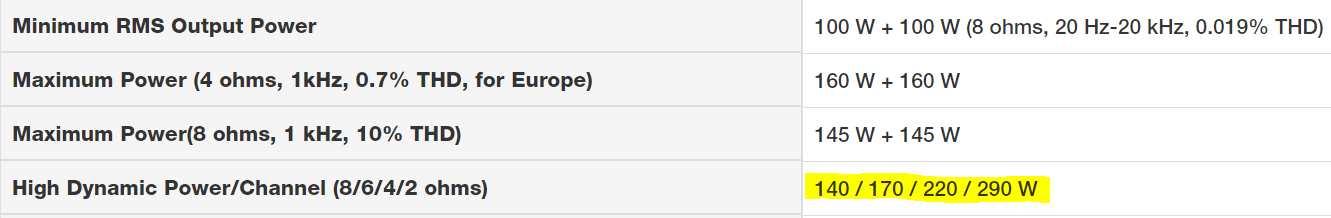

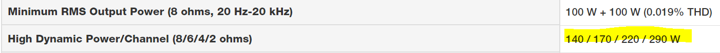

The A-S801 has a better power supply. Compare the power outputs between an 8 ohm and a 4 ohm load.
Huh. I was under the (possibly mistaken) impression that the A-S801 and R-N803 shared the same amplifier internals. From the Yamaha website:
A-S801
R-N803

My mistake. Yesterday I thought I had seen a lower output at 4ohms than at 8 ohms somehow. Of course, I can't figure it out now.
As you say, they most likely share the same electronics.
