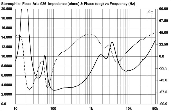

When amplifiers are being discussed, quite common their ability to drive low-impedance or difficult speakers pops up.
Is there a way to tell that a given amplifier or AVR can or cannot drive given speakers "properly"?
Take my example: I have Focal Aria 948 on front, Focal Aria 900 CC center, Focal Chorus 706 as surrounds, no sub. I use AVR NAD 758 v3. I listen to music at around -30...-15 db depending on recording, movies and games are about -25...-20 db.
Aria 948 impedance drops to less than 3 ohms and in reviews it's considered to be a "difficult load" for amplifiers.
But can I tell somehow if my NAD is totally fine OR I need to add e.g. external power amplifier for fronts? Especially since I don't use sub.

Yes, it's not powerful. But how to tell if it's enough or not? My speakers are quite sensitive, and from viewpoint of power it seems ok: -20db means that output power is couple of watts, right?
But my main concern is this "difficult to drive" thing which I can't parse from e.g. S&V charts.

Depends on how you define "a few". A lot of people listen to 75 dB average, 95 to 100 dB peak sitting no further than 8-9 ft, that would translate to an amp driving 8 ohm speakers with around 90 dB spl/2.83V/1M cruising at or below 1 watt average, 115-130 watts peak, no external amp needed in those cases. In your case, 80 dB average is quite high.
Have you tried the calculator @lovinthehd linked in post#4? That really is a prerequisite for this kind of questions.
Regardless, the 948 sensitivity is 92.5 so you should enter 88, or (89 at the most) into that calculator in order to allow for the expected lower impedance. Assuming you sit further than 10 ft, if you do listen to 80 dB spl average then I think external amp(s) will help for sure.

Aria 948 impedance drops to less than 3 ohms and in reviews it's considered to be a "difficult load" for amplifiers.....
Then my question would be what frequency or band where it hits 3 Ohms. I would think above 1 kHz, the power requirement for the same spl is much lower than say 200 Hz and lower. So you do not need much power to drive at 3 Ohms. Unless, the speaker has a crazy phase curve.

The "power cube" measurements shown in amplifier reviews in The Audio Critic are a good example of what such a measurement would look like, ie, measuring when an amp clips into different impedances (capacitive, inductive, and purely resistive).

#20
