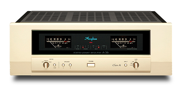

You see, Here people often talk about the importance of having substantial power in a well designed amp. Then again, other than being overpriced, I never heard one bad word about these high-end Japs like Accuphase:
Most of people seem to agree that these are not mere objects of desire and beauty, but really well engineered units. Now, the one in the picture has 2x30Wpch into 8 Ohms. THIS is why I asked all those questions. I wanted to know is it 'much ado 'bout nothing'.
The description says this:
In the output stage, power MOS-FETs renowned for their excellent frequency response, sonic performance, and superior reliability are used in a triple parallel configuration and driven in pure class A. This is sustained by the strong power supply featuring a massive transformer and two large 47,000μF filtering capacitors. Output power in each channel is rated for an impressive 150 watts into 1 ohm, 120 watts into 2 ohms, 60 watts into 4 ohms, and 30 watts into 8 ohms. Even speakers with ultralow impedance or drastic fluctuations in impedance curve can be driven reliably by this impressive amplifier.
OK, I see there's some 'sonic performance' talk, but you gotta have a wee bit of marketing. They also say that it could run difficult speakers. I guess it could.
If it is a pure class A design, and I am confident Accupase knew how to do it right, then the sonic performance talk were valid in the old days and even now, in theory. Modern class AB, D and other designes can just be as good in terms of distortions of any kind including IMD. I still prefer Class A just for the sake of it, not that I can hear the benefits. Too bad they are so heavy and relatively expensive, and run hot. For preamps, I would always go class A as there is almost no down side.

That Accuphase is an example of one with "regulated" power supply that doubles down; it has no dynamic power reserves above those power ratings, so if one had speakers and listening habits such that they never needed more than 30@8/60@4/120@2/150@1 peak output, then it would suffice. The low power reflects the practical limits of class A amps, which are all invariably toaster ovens. The price reflects the more expensive power supply, heat sinking, robust (more costly) parts, the fact that they are hand made in Japan by audio fanatics, and years of marketing to cultivate a cult status. Accuphase seems to me to be Japan's answer to McIntosh, as far as prestige status within the market...they even have power meters.

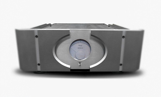

Which amplifier has more head room? the Pass Labs or the Denon AVR-X3300W.
Number of Power Amps 7
Power Output (8 ohm, 20 Hz - 20 kHz, 0.08% 2ch Drive) 105 W
Power Output (8 ohm, 20 Hz - 20 kHz, 0.05% 2ch Drive)
Power Output (6 ohm, 1 kHz, 0.7% 2ch Drive) 135 W
Power Output (6 ohm, 1 kHz, 10% 1ch Drive) 215 W
There is no comparison but the Denon offers much more power for 2 channel use.
