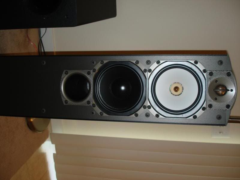

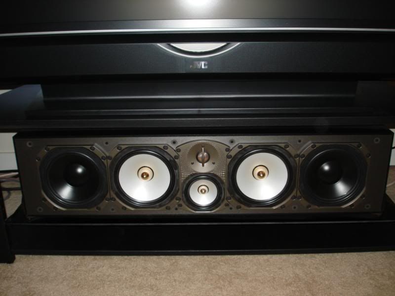

Thanks Im leaning towards the XPA 2 now that you've explained to me its more clear figuratively speaking : ) The Only thing is my center channel is a cc690 whitch is pretty massive and I think would utilize the extra power more then my 60's that are my left and right channels .My center is probably equivilent to studio 100's im guessing .

Wow... that's quite a Center. My Center is big, an HTM1 B&W but it is no where near the size of my Mains 802's. You may want to do an XPA3 then.. I'm curious to see what some of the other guys recommend, but that Center is pretty beefy. Maybe time to upgrade the Mains??? :D

UGHHHHH Nooo dont say that :p lol Ya my center ways in at about 70 pounds and is rated at a amplifer range of 15 to 300 watts were my 60's are only rated at 15 to 200 watts . You know I guess I could upgrade to 100's and use my 60's for rears and go to 7.1 :D Actualy not lol I wish but i've I got bigger fish to fry im in the process of upgrading my sub and then possibly the amp .

The simple solution is to do an even trade. Give me the 690 and I will give you the 590.
Otherwise, that 690 will need an amp. I am just trying to save you money!

Also, (forgive me if there's a different pic that I missed), but, I might consider (depending on present height of display, height of your eyes, how far you sit), getting the TV up higher to allow the center so sit on top of shelf (whether building something, or actually placing it on the center speaker). I think you would love the improvement to center speaker audio by getting it off the floor. Mine is low too, and I put a lot of absorption on the floor. My center is actually sitting on a treatment, which helped a LOT. still quite compromised, but I do what I can. It's the midbass that one would want to aim to absorb in this scenario.
Some speakers can handle TV weight. Contact Paradigm and see what they say. I know I've already helped someone at AH in deciding to do exactly that already.
