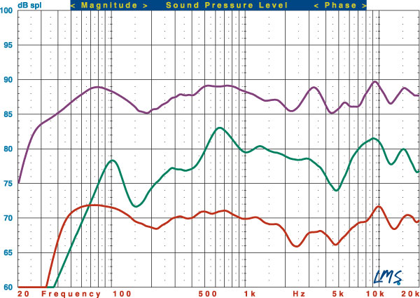

Based on one S&V measurements, I can't see how the LCR80 can sound good if neutrality is the reference so I agree with others that you should return them but again if that's what you like then try a more powerful amp.
Dreaming the Not-Impossible Dream HT Labs Measures | Sound & Vision (soundandvision.com)
Note that McIntosh claimed "The Crossover Network used in the LCR80 Loudspeaker System is designed to ensure an even frequency response over the entire audible range. "
The FR curve (green) below showed that it was anything but even!! That's for anechoic so in room could be better or worse as it depends.
This graph shows the quasi-anechoic (employing close miking of all woofers) frequency response of the XR100 L/R (purple trace), LCR80 center channel (green trace), and XR50 surround (red trace). All passive loudspeakers were measured with grills at a distance of 1 meter with a 2.83-volt input and scaled for display purposes.
