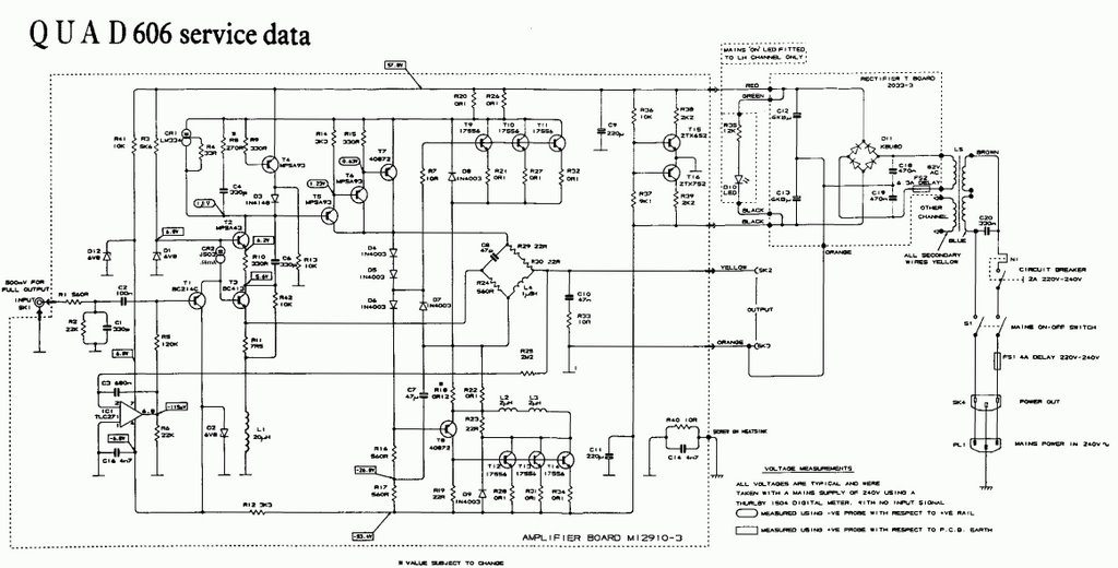

Not so, as I explained earlier. The Quad 909 uses a circuit patented by the late Peter Walker OBE. As I explained earlier these are what Peter called his current dumping amplifiers.
The circuits of these series of amplifiers are totally unique. Only Peter Walker ever designed such unique and cunning circuits. They are feed forward class C amplifiers to give them there correct designation.
The class C dumper stage produces the power. However there is a very accurate small class A amplifier that provides feed forward error correction to the dumpers.
Peter showed mathematically and on the bench, that the specification is dependent on the performance of the small class a amplifier, which is very good indeed. These amps are stable, highly linear and have zero crossover distortion. Peter's circuit comes closer than any other to achieving the goal of the wire with gain.
These amplifiers give prolonged trouble free life and components can wander widely from original values over time and the performance of the amps is unaffected.
I have used his current dumping amps exclusively for over 30 years now, and I doubt I would ever change to another amplifier topology. I'm in good company as the BBC have been wedded to these amps as long as I have.
These amplifiers sound really sweet and are the product of pure genius.

TLS Guy, what you are describing makes no sense to me. I don't know if you have an electronics background, but a Class C current dumping feed forward amp means nothing meaningful to me.
The characteristic of a class C amp is that it is conducting for less than 180 degrees of the cycle, which means by default it switches off. By switching off it must go into it's non-linear operating area and therefore produces distortion. Class C amps are used in RF amps, oscillators, mixers etc. where the load is a tuned circuit and the amp operates for a short period of time to top up the energy in the tuned circuit.
Feed forward is very similar to feedback, both schemes are a method of introducing out of phase signals to reduce distortion and noise and to flatten freq. response. I don't know what is meant by current dumping.
I don't know if the Quad is a great audiophile grade amp or not but the description does not lend itself to an audio amp.
There have been endless debates about how Peter's circuit works, but work it does. Peter told me personally that he regarded it as as Class C feed forward amp that is unique. Although Pass Labs have possibly infringed on his patents.
I see that the current owners of Quad now describe it as class B feed forward. However the point is the specs are set by the class A amp. I see on some forums posters regard the circuit as a servo amp.
Quad amps are among the most tinkered in the DIY world. Peter's brilliant circuit has provided a lifetime of fascination for many. However music enthusiasts have enjoyed his products for generations, and plugged them in and not given them a second thought for years.
I could not find a circuit on the net for the 909, but I did for his 606 which is similar.
Here is a link to the Quad 909 manual.
Here are couple of sites for the large number of Quad enthusiasts around the globe.
http://www.geocities.com/ResearchTriangle/Lab/6722/
http://quadrevisionspot.blogspot.com/
Enjoy yourself as you delve into Peter's unique amp circuits.
