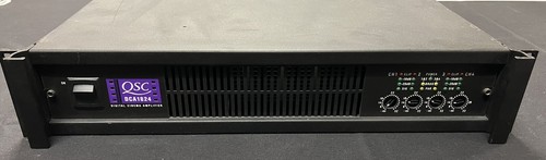

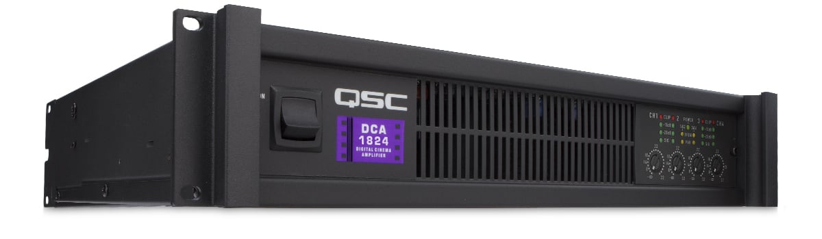

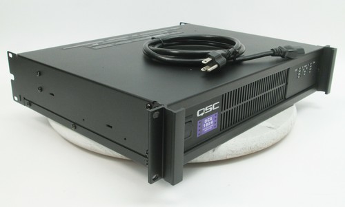

In his planned budget, IMO the OP could get a Crown XLS 2002 to drive the subs and a QSC DCA 1824 amp for driving the wall speakers:
That DCA 1824, contrarily to the seller's posting, is indeed a 4 channel amp. I'm using one in my HT.
Does he have a preamp-processor or an AVR with preouts to drive them. We need to know.

This one is still listed at $799 by a reputable seller:
EDIT: It's a four channel amp:
I didn't look at the Subwoofer specs. The Crown XLS 1502 would most likely be powerful enough then.
Heck, maybe even an extra channel of a 5ch amp....and the speakers are relatively sensitive, too.
