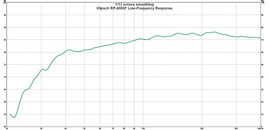

Ground pane FR of his main speakers.
You can see that baffle step compensation is not quite adequate.

So lets see what we have here.
