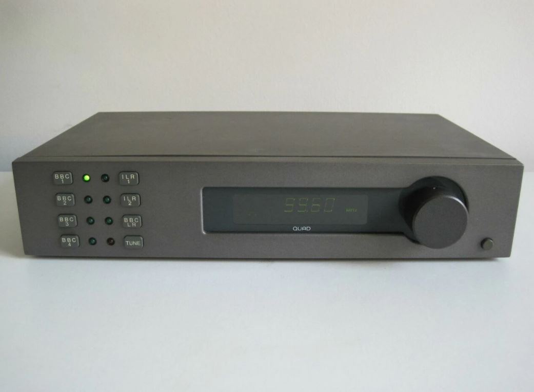

In this age of streaming though, the FM section very much tends to be an afterthought on current gear. The age of the high end analog tuner seems to have passed.
I use Quad FM 4 tuners in a couple of my systems. I think they were one of the best, if not the best FM tuner of all time.

I am actually listening to the Minnesota Orchestra live this evening on MPR classical FM. They do have a stream but it is Mp3 and only 128 kbs. The FM via my Quad FM4 definitely sounds better, and substantially better. It is also better then the FM radio in my Marantz 7705 AVP. Marantz no longer include HD radio in their offerings, Not that, that is a lot better.
So I am glad I have my Quad FM4s.

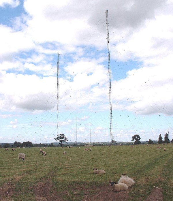

Below is a picture of the most powerful AM radio station in the world. This is the BBC AM radio transmitter at Droitwich. This one station can cover a good portion of the globe and can broadcast deep into Russia. The point is see all those long wires strung about, as AM has such long wave lengths.
In truth though, you may find that you get very bad AM reception with that unit, and will be much better off with a portable radio for AM. These Roberts radios are about the best of their kind.

Here is a history of the Droitwich transmitter.
I suspect the US will follow. The UK will stop AM broadcasting in 2027. That will be the end of the history of Droitwich. Hopefully it can be preserved as an historic site.
