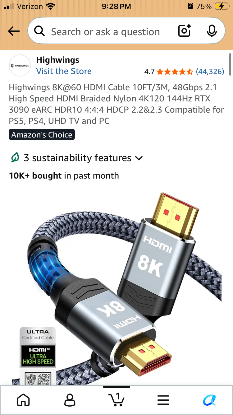

I like the braided nylon cables in general. I have purchased Snowkids cables before and they have worked fine. Amazon seems to be pushing cables from Highwings and the build quality looks pretty good on those as well. 10 foot cables from those brands are under $10. No need to spend 3 or 4 times that on the Monoprice or Startech 8k cables. You can probably get away with 12 foot but, like the doc says, at 15 feet you're pushing your luck. Unfortunately active cables really jump in price and with your older receiver you will likely need a power-inserter as well.

I’ll measure if I need a 15 feet , but 10-12 foot might reach . I’m using some off brand now I’ll get a pic eventually of it …them .

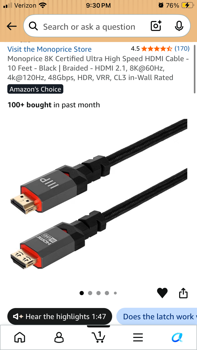

I’d go with the mono price they seem to work flawlessly in my system .
