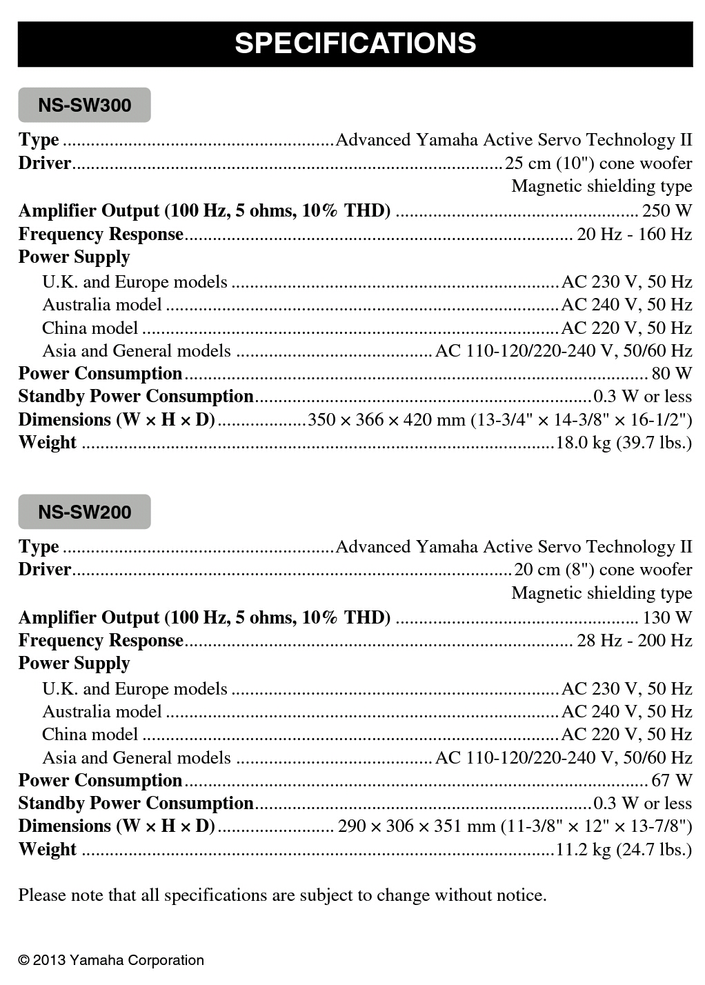

Any comment on yamaha ns-sw210? 150 usd and available locally. Surprisingly, it is active servo controlled at these price.
8 inches, 130w. User manual is clear and technical. Evidence of the level of engineering team who make it
8 inches, 130w. User manual is clear and technical. Evidence of the level of engineering team who make itView attachment 25788
I wouldnt choose them if I were in the budget category. I'd doubt the FR is at -3db, probably down 10, maybe.

To everettT, do u meant that i should not buy sub if i am at budget?
are u querying the low end of their frequency response spec. Servo is suppose to make says 8 inch sub perform like 10 inch sub.
everettT
everettT
Not saying to not get a sub, but I (me) wouldnt be looking at those two. As for the servo, it dosent make one perform like a larger driver, but operates more efficiently with better cone control.
