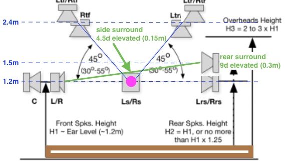

Just to add to @Ed Mullen. You’re right about a specific height for surrounds, but it does show h2(surround height) shouldn’t be more than h1(mains height)x1.25. I agree that about a foot above works well due to couches and other listeners heads. Mine ended up at about 1.55xh1 and works great.
