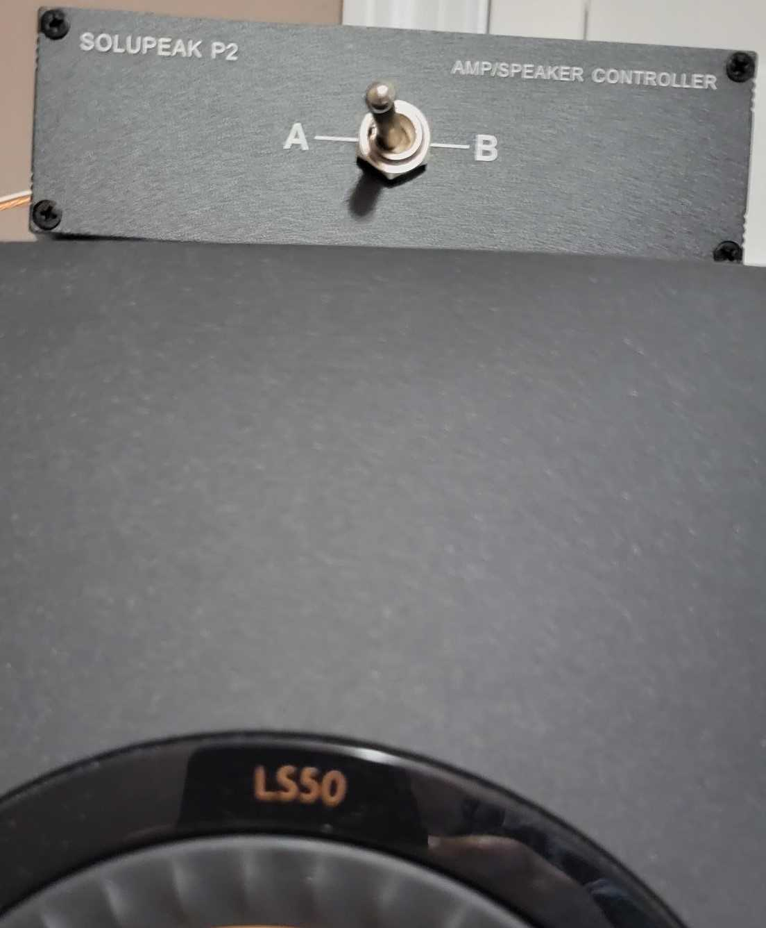

So true! If people invest a couple hours and less than $100 on an A/B switch to do a blind test they will save themselves a lot of money on those expensive components such as separates, or worse, the silly integrated amps that almost never do audibly better than mid range AVRs. I have done those AB test and by having an AB switch permanently connected, after days, I am100% sure even my cheap $79-$89 Fosi Audio V3 amp sounds exactly the same as my other much more expensive amps.
After doing many of such comparisons, I have already given my Bryston and Parasound Halo amps, though I will keep my remaining separate preamps/amps, mainly as I still have use for them and just don't feel like given away everything so soon.

@PENG I had discovered all those high-powered amps I had accumulated over the years were really a waste of money spent. When that money should have been spent on where it would have given me the most Improvement in sound quality my front L/R speakers throw in Center channel for surround sound.
By chance really, I decided to add an A/B switch so I could use both my AVR and a 2.1 channel Stereo receiver, for just use of my front L/R and Sub if I wanted to use the Sub at all for 2.1 with the 2 channel Stereo receiver. I discovered at the volume of very high output was only when those added amps came into good use. Sure you have a huge room, front main speakers with a low impedance dip or you went the full Monty, with Dolby surround, added amps more than likely will be needed.
Back to the future :) Speaking for myself, Choosing an AVR to pull double duty 5.1/2.1 or what ever mode of Dolby surround is a personal choice. Were tradeoffs for me at this point.
