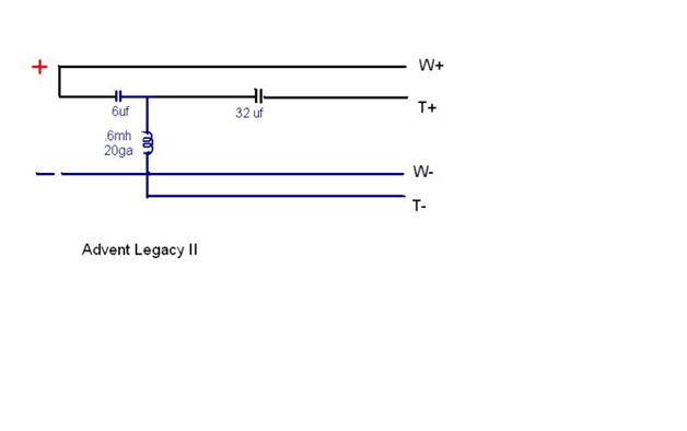

I have done some further research on these speakers.
This is the crossover. This crossover is crude. There is no woofer crossover, it is run full range and allowed to acoustically roll off. So the 10" driver will be run into and beyond break up range. There is a third order high pass to the tweeter. There seem to be a faction that believes because it is old it is good. All periods have had there junk. This is an example of 70s junk.
Welllll...........That's more sophisticated than the original large Advent, which also had no low pass filter on the woofer, and either a first or second order electrical filter on the tweeter (I don't remember which). Same thing for the Dynaco A25, which was anything but junk. That's just how they designed back then. The large woofers were smoother at the top end than such woofers typically are today, and many were able to approximate a decent low pass slope. I've never heard the Legacy, so I don't know how well this approach worked with its drivers.
