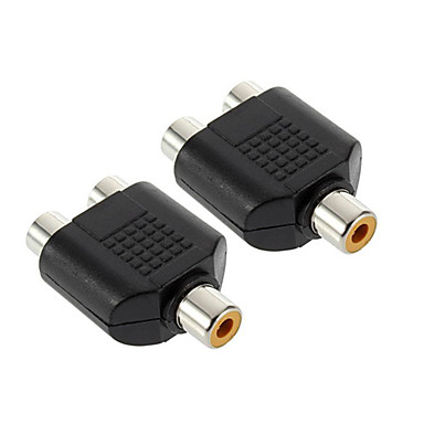

The method in the video works perfectly for the 3.5mm input. If you needed to use Input B, the RCA L, R, simply put 2 female to female Y-splitters on the signal cable and run a second RCA cable to the sub.
Something like this,
What is your source connection?
