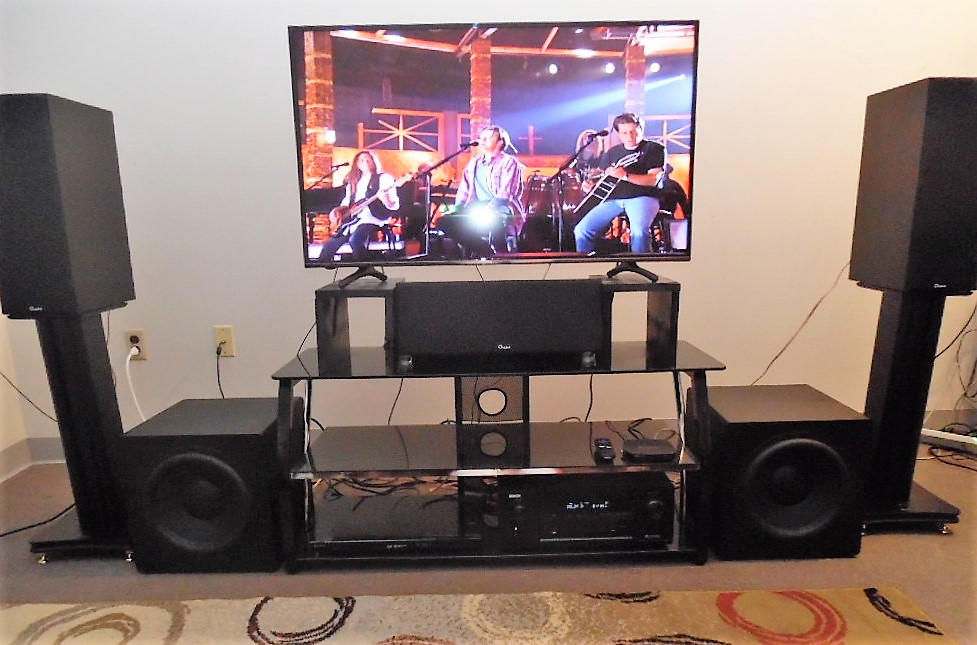

Kurt, at one point I owned (4) of the SVS SB12's. Had (2) up front like I had the S1500's AND the other (2) directly behind my seating position. The low end did sound a bit smoother, but the SB12's were no match for the dual S1500's inmho. I also placed (2) of the SB12's to the left side behind my seating position to very little difference albeit near-field. Here are a few pics for you:
Of course things are totally different now. But, the (4) SB12's were no match for the dual S1500's. As you know my preference is on music and that I prefer sealed subs. Anyways, hope that this is of some help to you.

Phil, are you sure it wasn't partly due to placement choices? Symmetry don't mean much to a sub....

Well, given that my room is rather small placement was and still is an issue. However, I just preferred the sound of the dual S1500's as to the smoothness of the (4) SB12's. The low end was smoother sounding with the way the SB12's are placed in my pics. When I co-located (2) of the SB12's to the left side behind my seating position albeit more near-filed, there was very little difference. Over all, the dual S1500's were much more to my liking. In a bigger room that could easily change. Who knows? For the time being, I am not even using a sub. :):):)
