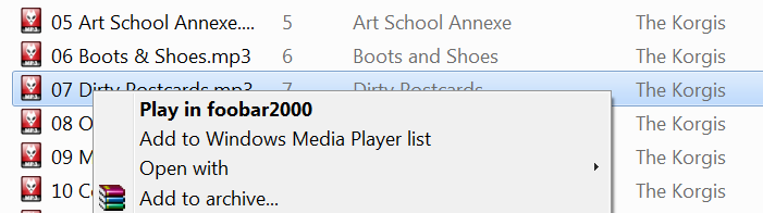

I have a slight issue with the Foobar. The way it integrates to menus and sub-menus should allow you to add files to your currently playing material. My Foobar does this for some files and not the others.
Did anyone have this problem before?
I was looking around the Internet, but couldn't find anything helpful. I did associate Foobar with all file types and if I double-click any of them, it'll open in Foobar.
But, when I right click certain files the menu offers Play in Foobar or Add to Windows Media Player and not Foobar.
I did transport these from an old HD that went bad, so I'm thinking whether there could be some sort of 'read-only' type of protection that prevented Foobar to fully associate with my files, but I'm only guessing.
Any ideas, people? Can this be fixed?
EDIT: I forgot to say that sometimes it's the same file type, i.e. some mp3's I can add to Foobar and some not.

Possibly, yes. Not by me, though, some of them I got from some friends.
Assuming it could be these DRM controls, is this solvable?
My PC crashed recently, but I could enqueue all of them, for example, in winamp (the same files) on my old setup.
This is how it looks for me with certain files.

Thanks anyway. I'm sorry for putting you in the spot. I didn't realise this would mean threading the gray area.
I thought, since I can play these files in Foobar, why wouldn't I be able to queue those exact same files in Foobar?
Don't worry, I'll figure it out. And thank you for the help.

I solved this so I just wanted to post here to have this topic properly closed.
In preferences, under shell integration you can check the box to set enqueue for all file types Foobar is associated with. Some of you probably knew this, for all others, it's here now.
