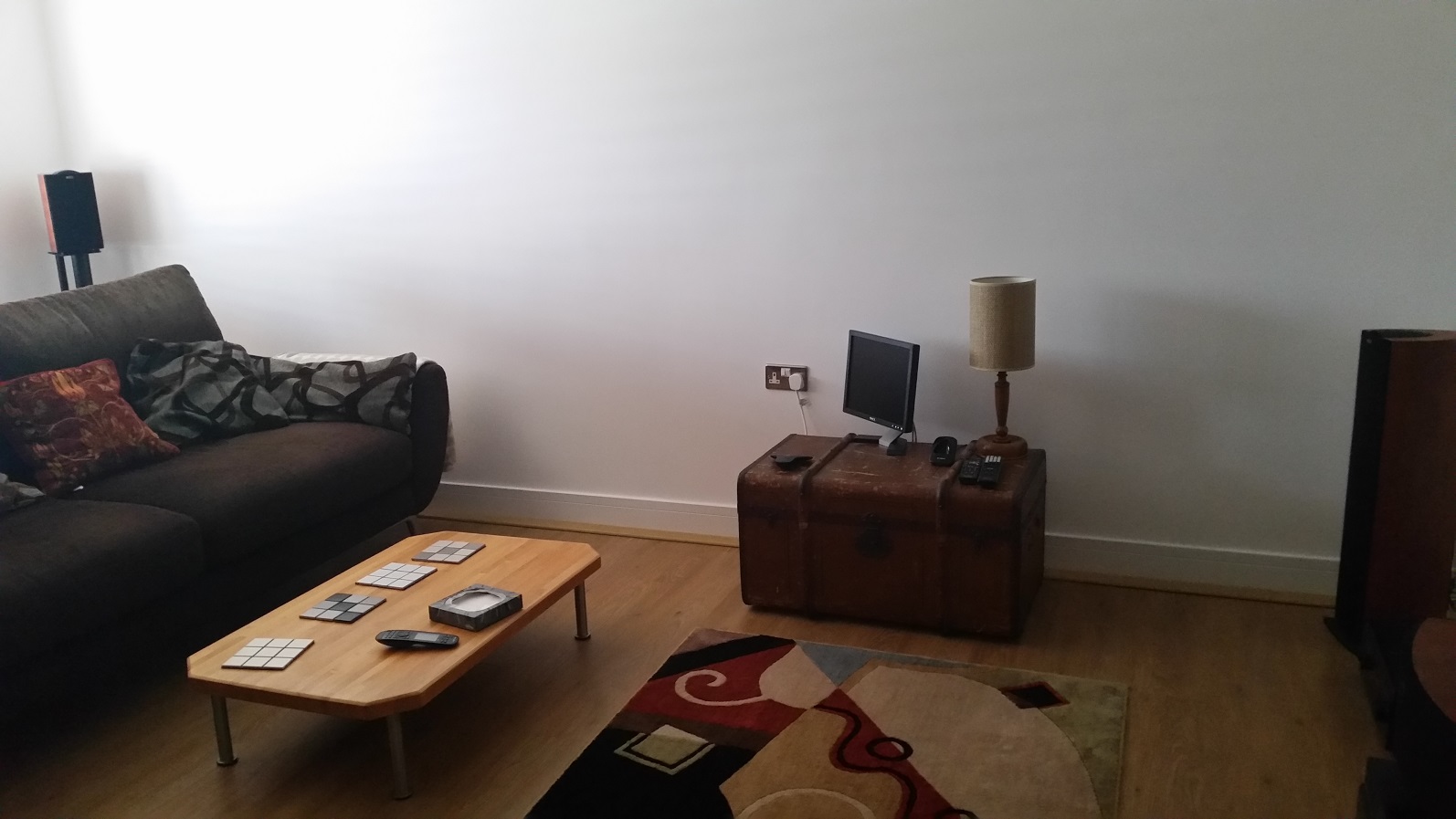

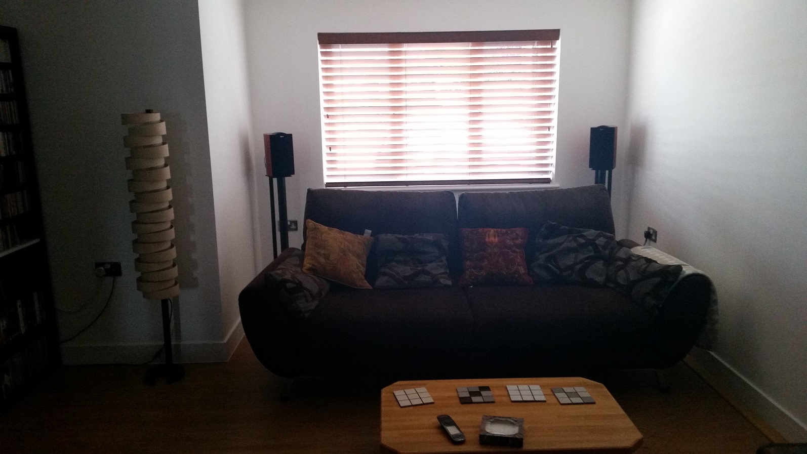

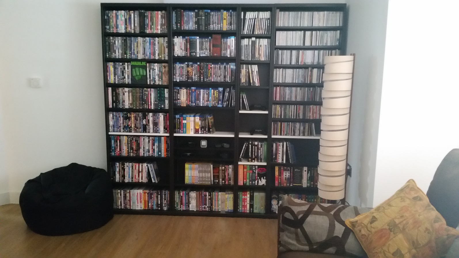

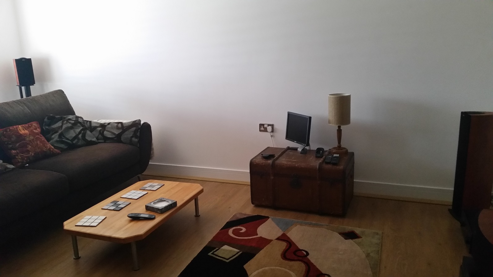

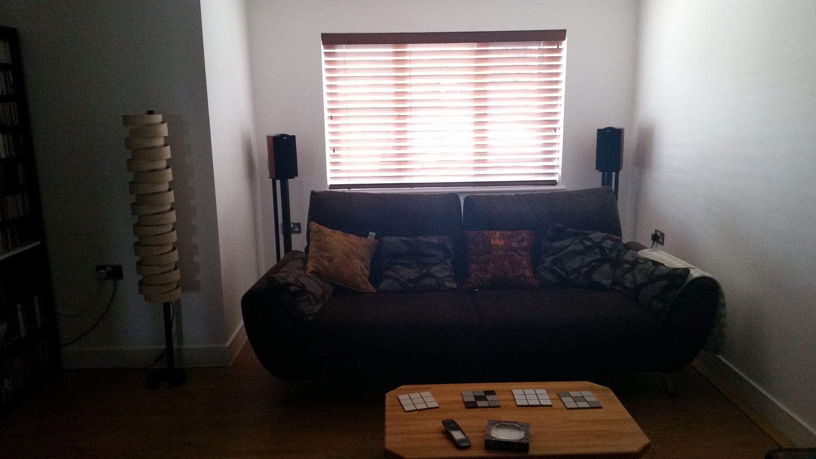

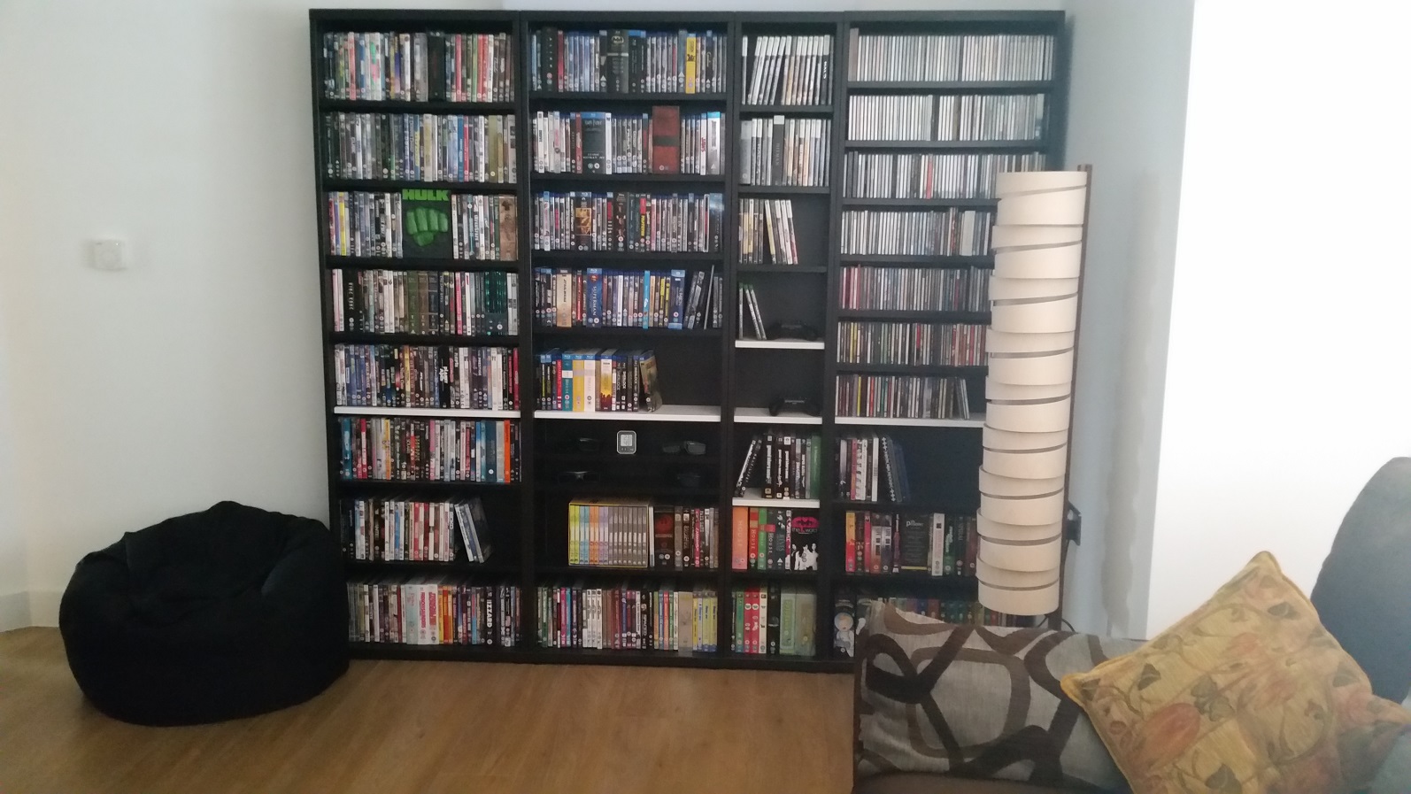

2016-07-31 17.59.44.jpg 2016-07-31 18.00.38.jpg 2016-07-31 18.00.58.jpg 2016-07-31 18.01.21.jpg
Okay, thank you. I attach some photos of the room, the measurements from longest wall to longest wall is approx 18 feet x 13 feet, if you have any suggestions on placement or acoustics improvements that would be great! The sub woofer is behind the sofa between the surrounds, so out of shot.
View attachment 18909 View attachment 18910 View attachment 18911 View attachment 18912
Those photographs are helpful and tell me what you problem is. You do not have nearly enough soft furnishings, especially the floor.
You have the speakers right on hardwood floors. You will have a very nasty first reflection. That will muddy the sound right away and obscure detail. The speakers need to be on a soft rug extending at least 6 ft beyond the front of the speakers. Some soft wall furnishings would also help a lot. More soft chairs would also help.
Also you need to experiment with sub location as the room from the pictures looks to be relatively square, with no long very dominant dimension.
To me that looks like a difficult room. It definitely needs some deadening, especially the floor.

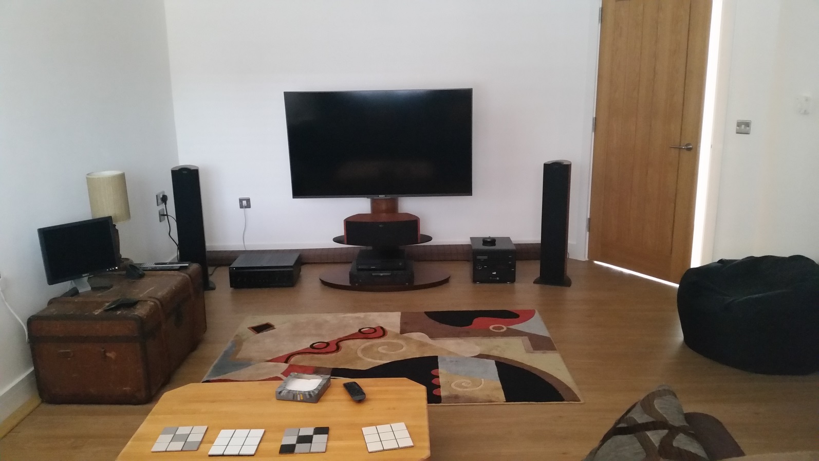

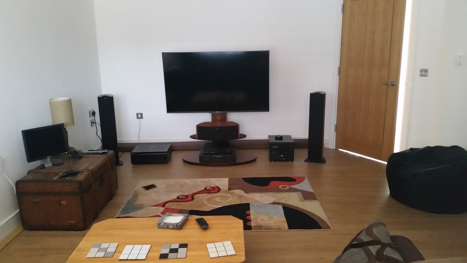

Well, thanks again for everyone's help, I have spent a fun o_O evening moving everything around, and have definitely heard some improvement to the sound. The 'sweetspot' seems to be as shown in the photo. Not the most practical location, but will have to find a way to make it work, a bigger rug might be a good start!
I'm still curious to see what (if any) difference the Behringer will make, so I'll update when it arrives and I've had time to experiment.

Just thought I would re-visit and let you know that all your help was not in vain, and I finally have things sorted out and sounding wonderful :)
The biggest improvement was the rug, and the speaker placement. That really got rid of the harsh sounding treble, and made everything sound much warmer and mellow.
I also decided to get a new CD player, a Marantz CD5005, as I wondered if my 15 year old Denon player might not be performing at its best. This was a small improvement in sound quality, it has three sound modes, including a pure direct mode which I can hear a difference between.
The Behringer A500 power amp is also staying. It is not a massive improvement, but it certainly does sound better with music in stereo mode that just using the Sony AVR. The Sony sounds a little 'muddy' the Behringer sounds crisper, and I can hear the different instruments and voices clearer. It has introduced a small buzz and the odd popping sound, so I am going to look into getting a mains conditioner device for the room.
I also got a new blu ray player whilst I was on a spending spree, purely because the Xbox One is horrible as a blu ray / dvd player, and I wanted one with dual HDMI outs so I can put video straight to the TV for 3D discs, and audio direct to the AVR to get the HD audio formats.
I also replaced the kef speaker jumpers with some I made myself out of some left over speaker cable, this probably made no difference at all!
So thanks again to everyone that helped me out with this, great forum, and I really appreciate it!
Here is a pic of the new set-up, complete with the 70's rug..
