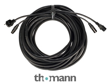

There are combined power and signal cables like these of various lengths.
You can’t run those behind walls.
Probably not, but then you can drag proper cables following proper building rules. You’ll need an electrician as well perhaps.
Which, again, adds a lot of additional cost to the installation. To fit active speakers in a nicely appointed room you’d want recessed power outlets and signal jacks behind each speaker. Add that up for 9-16 channels, plus multiple subs. Probably a network cable too, for control features and Dante or similar future proofing. Or you could just run 14/4 speaker cable to each position with a brush plate, and keep all the electronics in one place. Then the only electrical work needed is a dedicated circuit with an outlet by the electronics and an outlet by the display.
