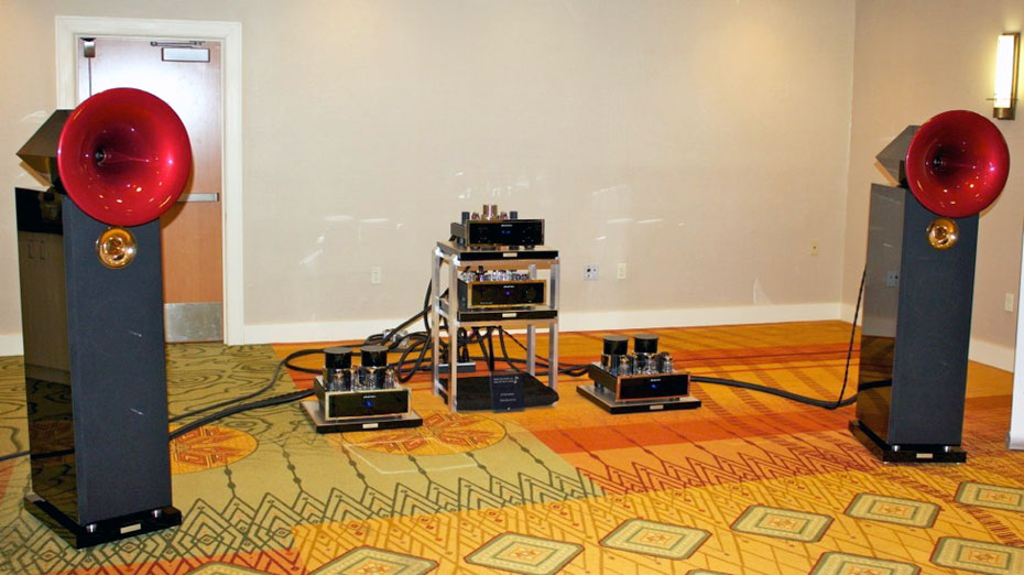

Best ever was this system.....https://goo.gl/images/9sud4M
It's one of the only speaker systems I've heard that uses a plasma tweeter.
