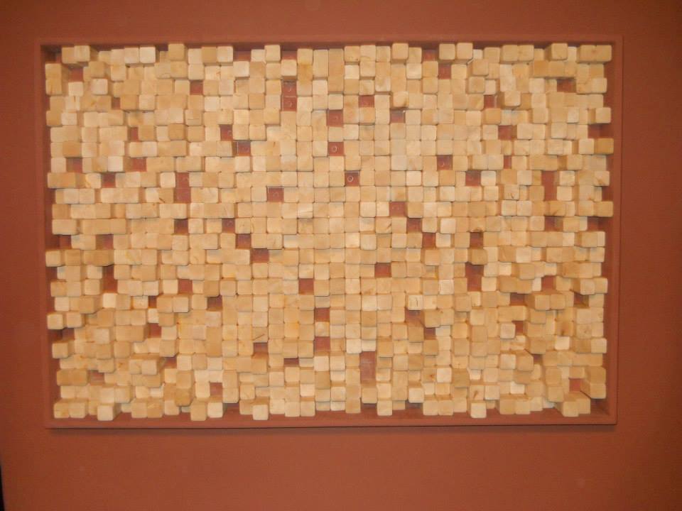

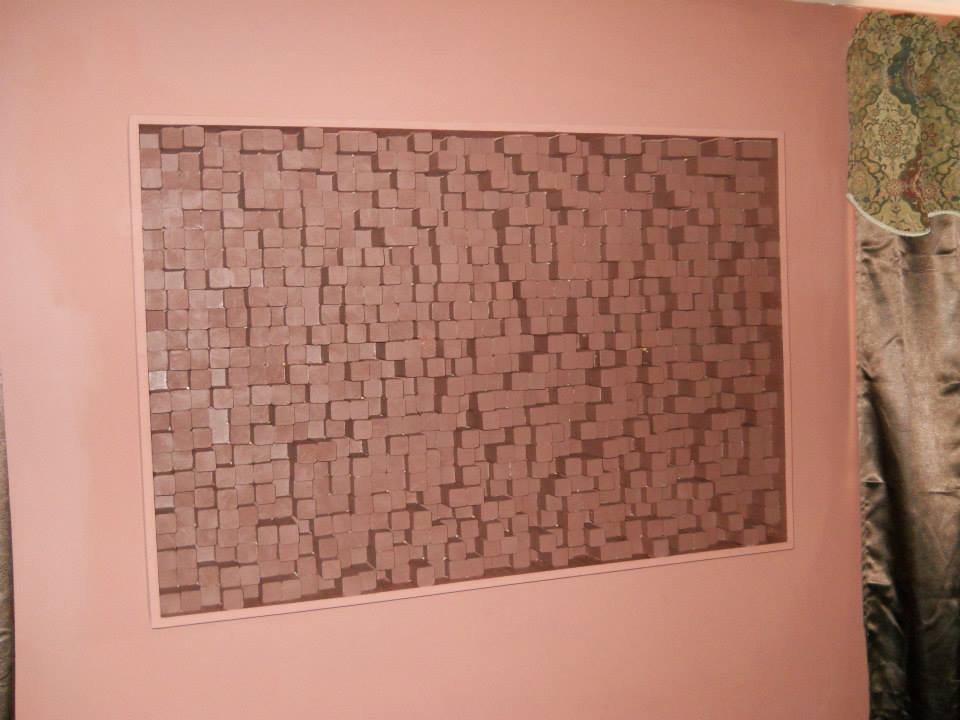

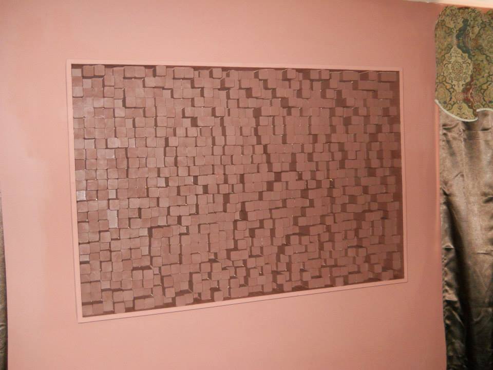

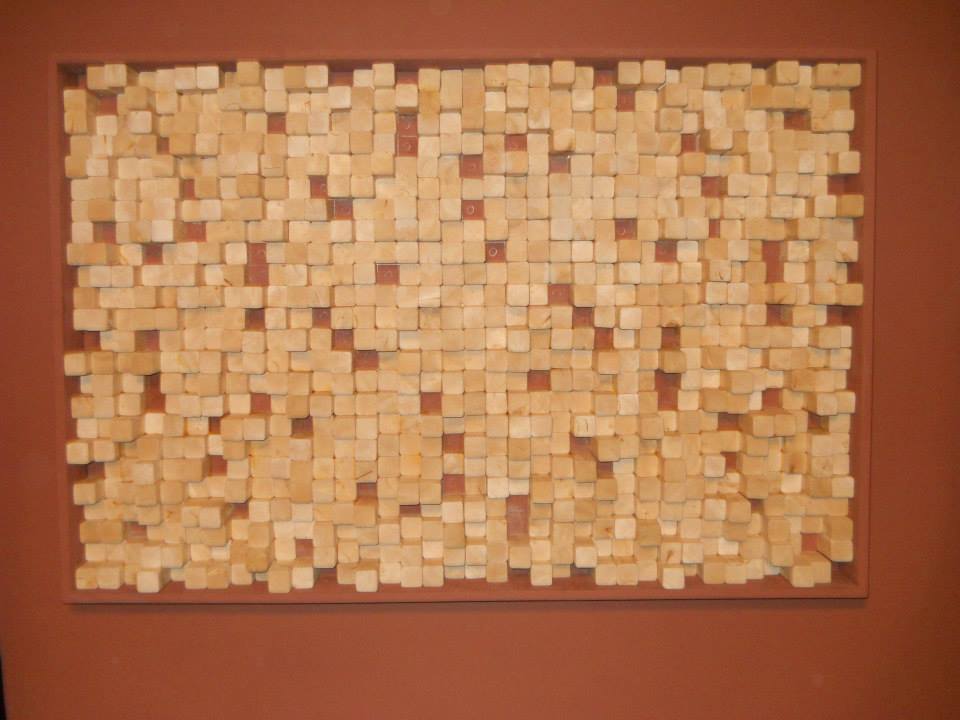

Just curious, how long did it take you to build that acoustical diffuser with the wooden blocks? I watched a couple youTube vids on that a while back. I'd be running my patients really thin trying to make one of those.

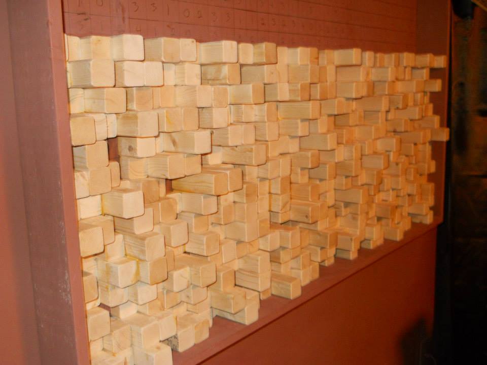

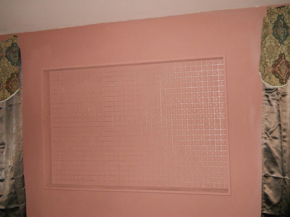

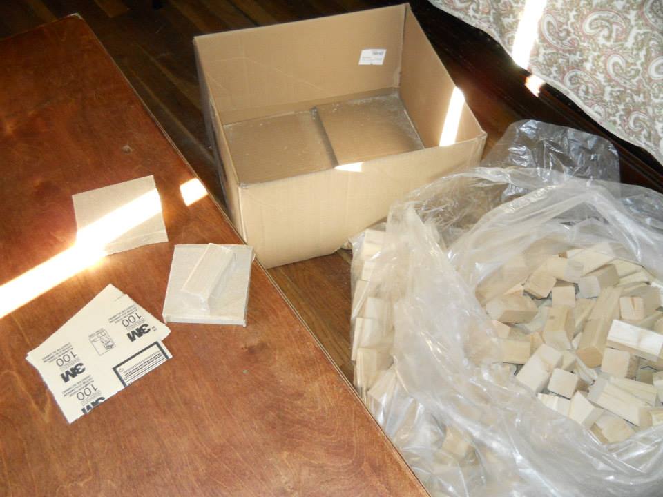

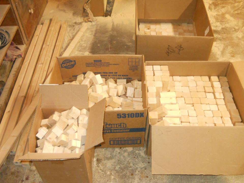

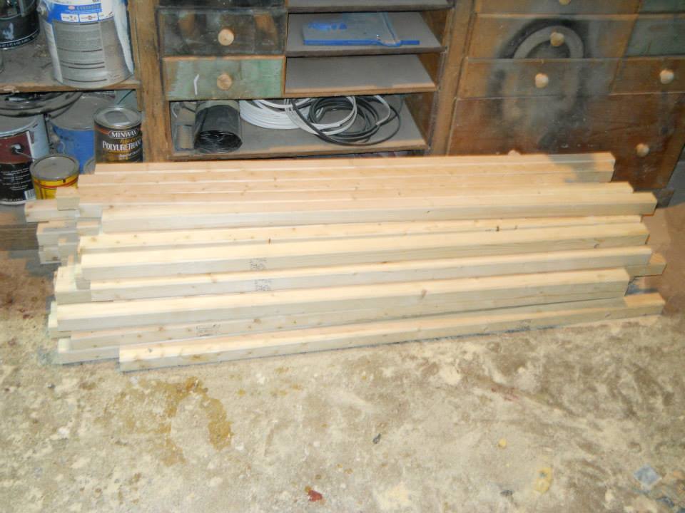

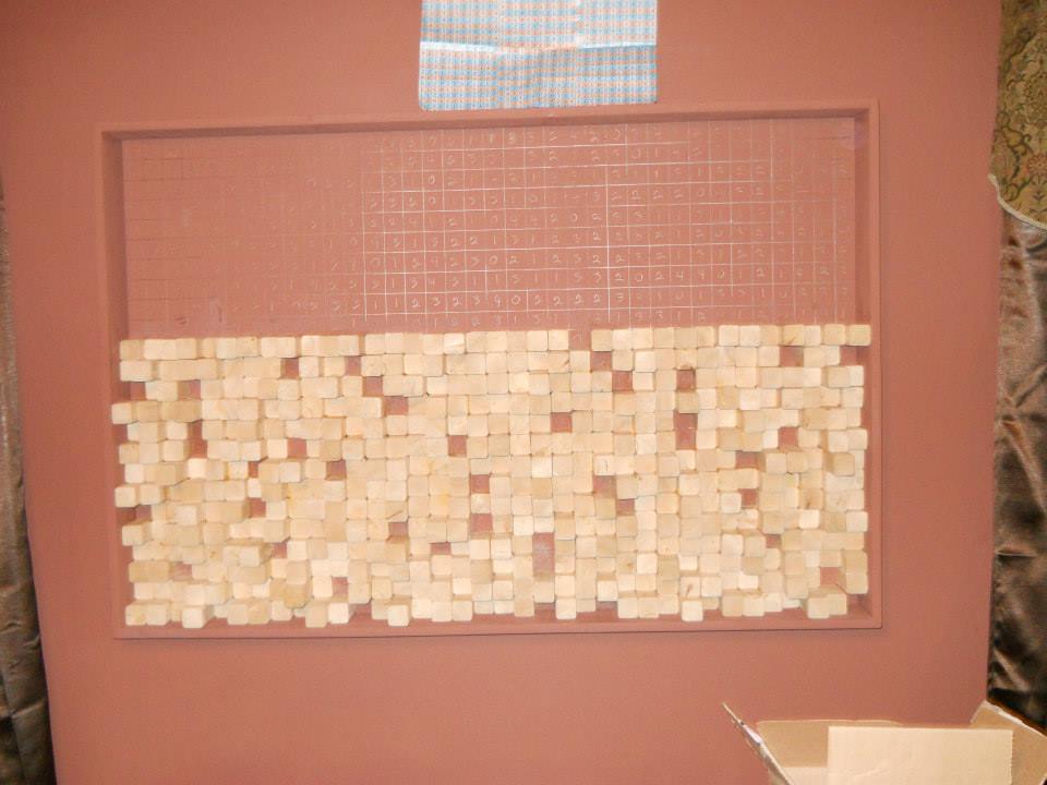

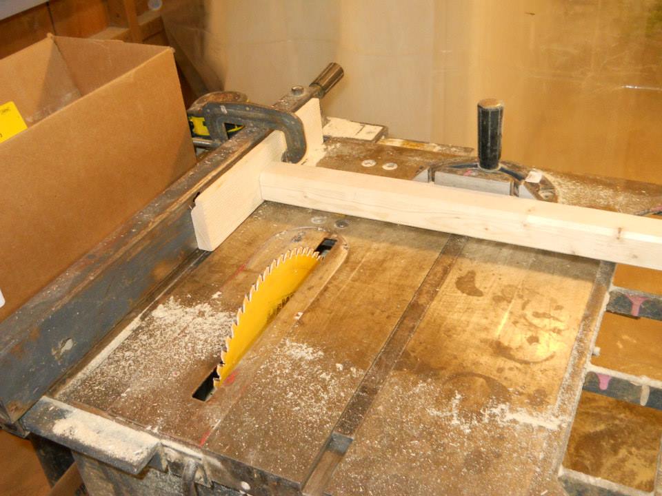

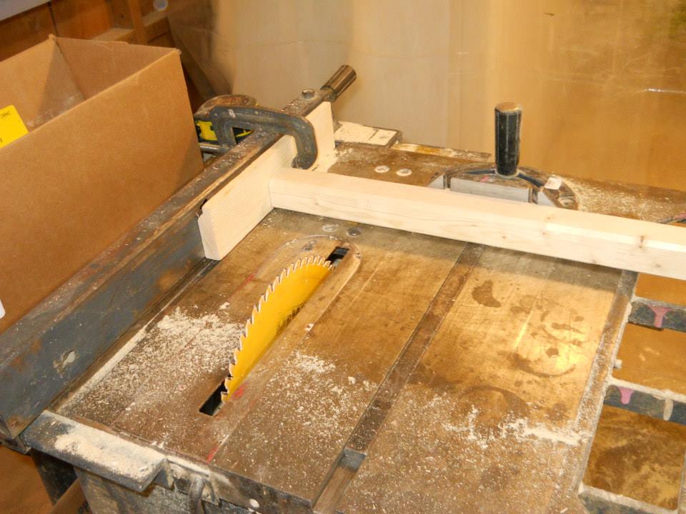

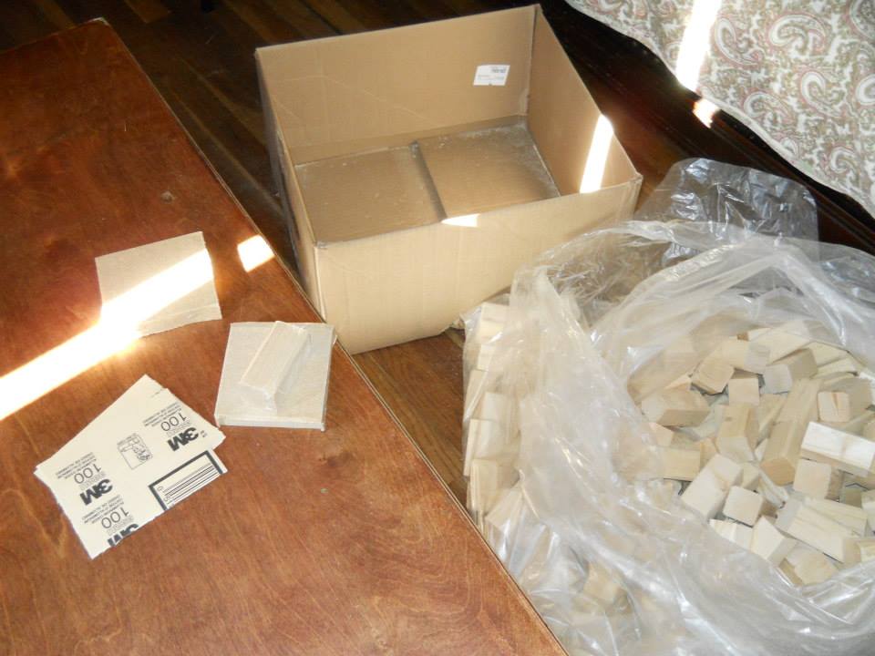

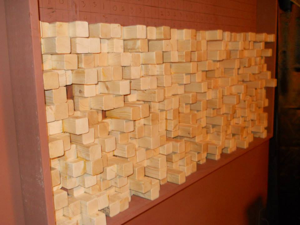

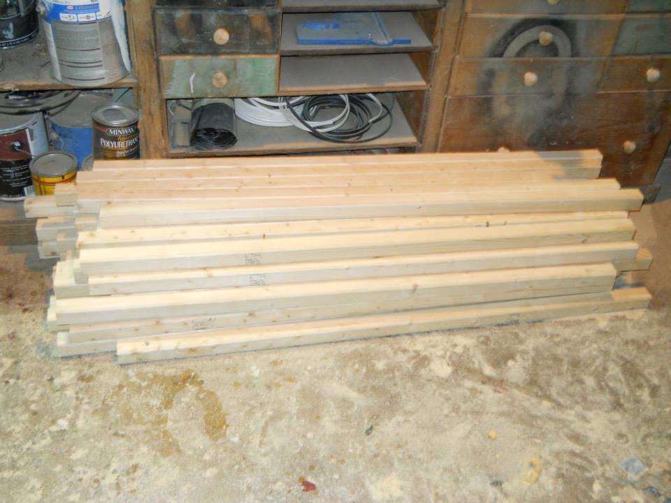

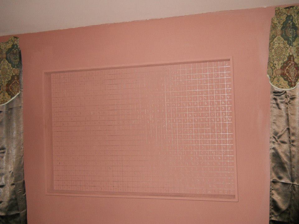

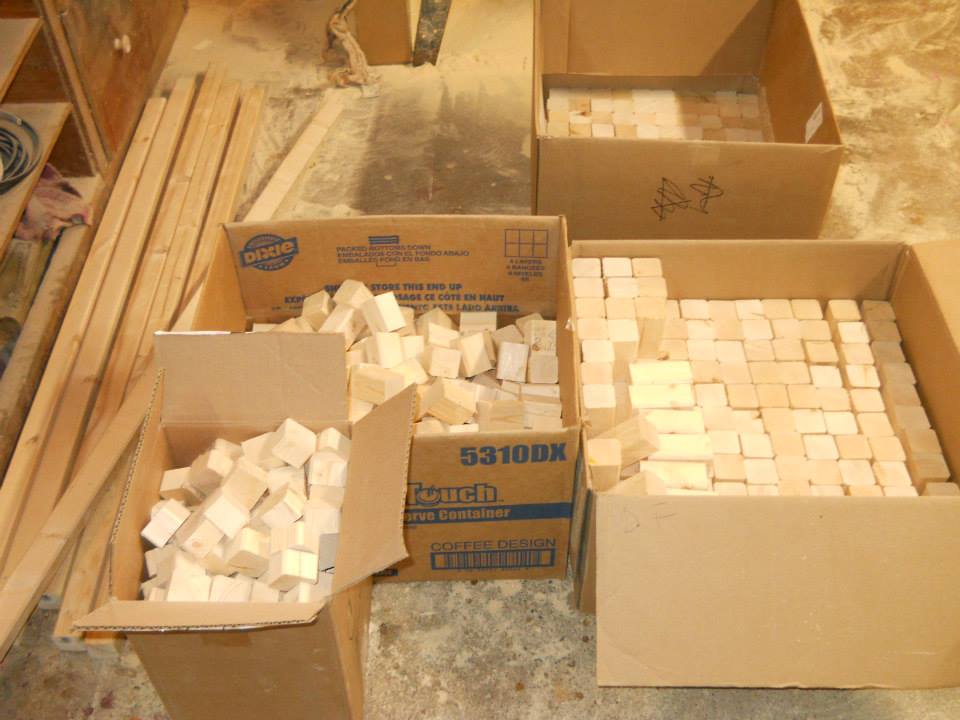

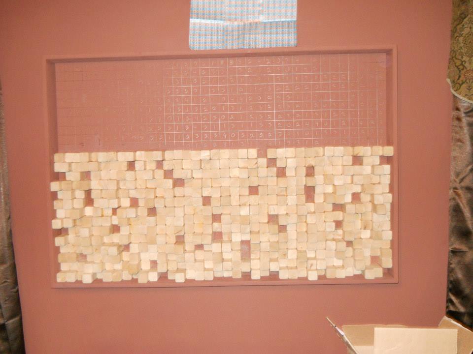

Think it took me about a week. An hour here and a hour there kinda thing. There was a web site that you list your room's dimensions and it would give you a numerical pattern . I built the box on wall first then transferred the pattern on to the wall and then cut 1 3/4 "x1 3/4" "or what ever a 2x4 really is now a days" into blocks at different lengths as pattern called for. Sanding the fuzzies off the blocks took for ever.. Here are some pictures of the build
923130_1414058212175917_821349923_n.jpg1654299_1415285348719870_350768469_n.jpg1798608_1415987638649641_986224934_n.jpg1888691_1415285278719877_1223800300_n.jpg1897973_1415285422053196_446871553_n.jpg1899925_1415987425316329_1976807914_n.jpg1901460_1415987388649666_437071781_n.jpg1908256_1414058328842572_1577410335_n.jpg1965000_1416275295287542_1890595148_n.jpg pics of the build

Wow, very impressive! nice work.

Your name is a good reflection of your room. Nice job on the diffusion wall. Simple, but time consuming.
