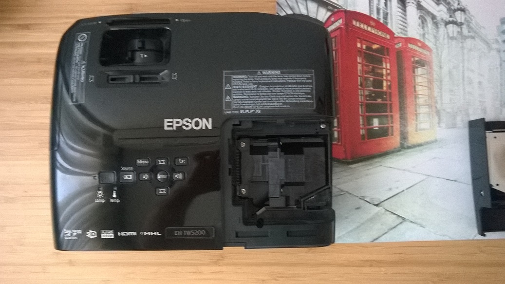

Yes, it's an Epson. Entry level EH-TW5200. I'll open mine and let you know if I find something. I will at least take the lamp out. That shouldn't be a problem since the user is suppose to change it anyway. I somehow doubt this will do any good. If it's inside it will probably be on the LCD screen. I'm just guessing.

I still didn't find the time to open it and peek inside. I will.

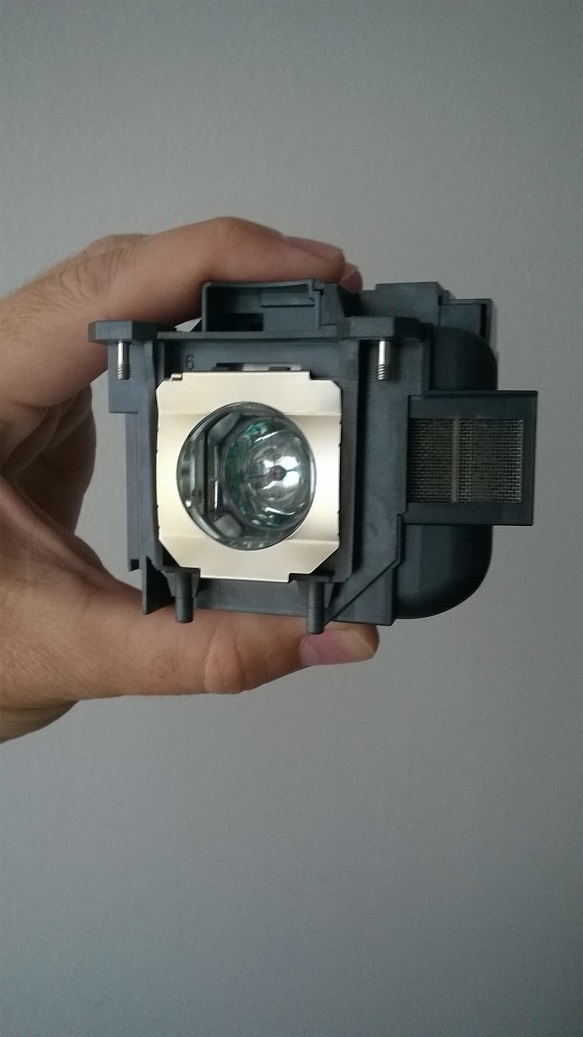

I wasn't able to find even a tiniest mark on the lamp or the glass screen directly in front of the lamp. Further digging towards the LCD screen (this is a LCD projector) was not an option for the time being.
I'll keep with the research.
