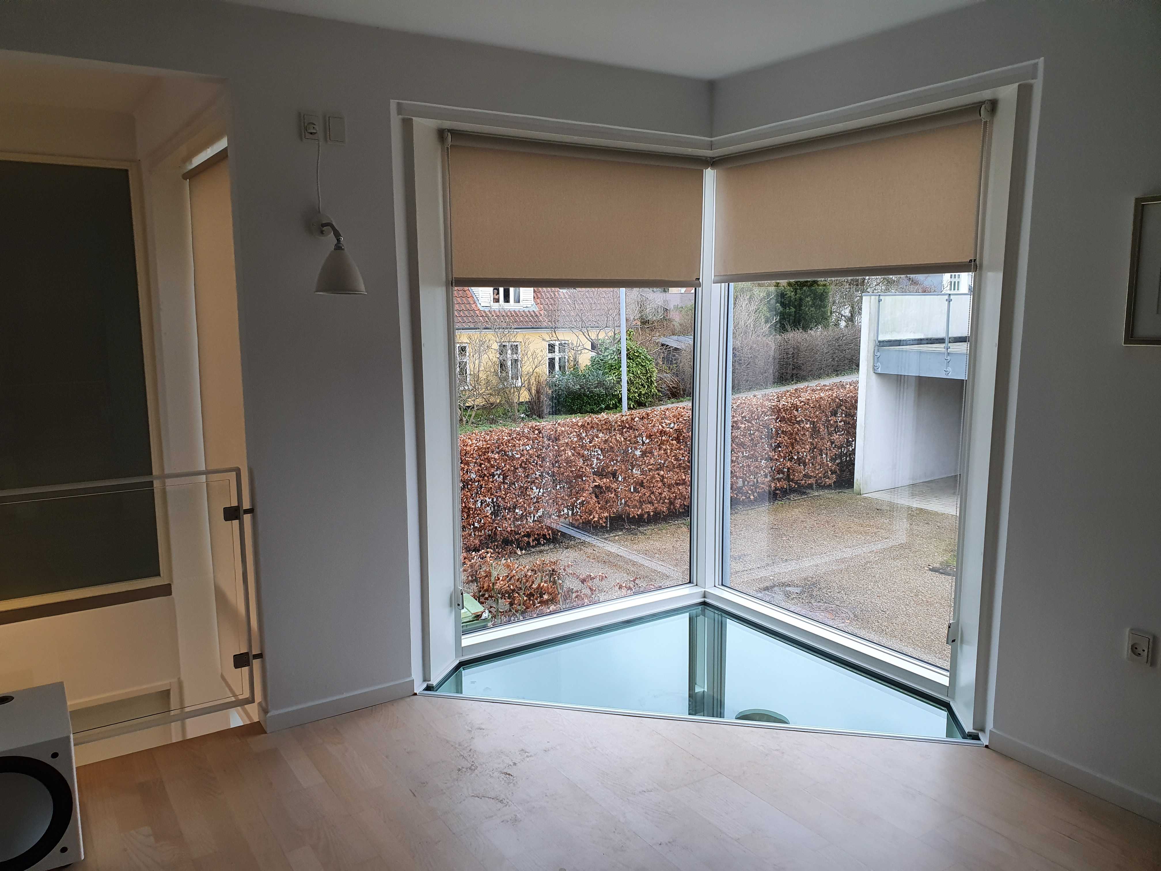

I have attached an image of roughly how my setup will be in the future plus a couple of pictures that show my current setup and a few things which complicate matters - at least in my head. So here is what I'm primarily struggling with:
  • I'm going to put a carpet on the entire floor including the glass section. So I guess it should be OK to put speakers and subs on the part which is glass?
  • Can subs be placed further back than the front speakers in the room? That would be the case if I place them in the corner agaist the window for example
  • If I want to go by some popular options for placing subs one would be putting them against corners in front of the MLP. But that would mean that one is placed against the window. Would that work?

The corner window – I’d expect the concern would be that the sub would make it rattle.
Regarding your proposed new arrangement, could you flip the set-up, with the “front of house” being at the proposed sub location? Would that allow both subs to be in the front corner?

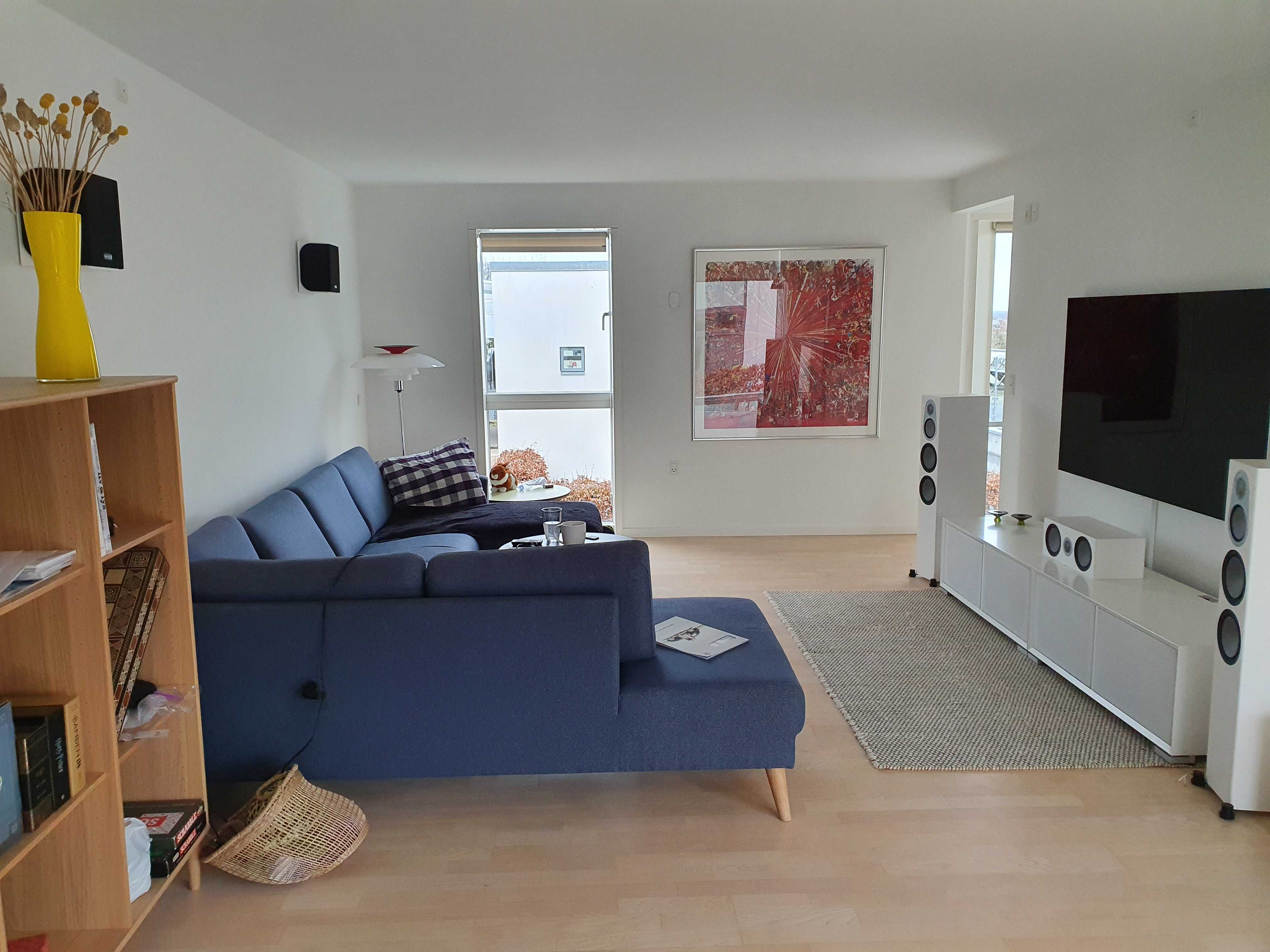

Thanks for the reply. I'm glad that I'm not alone in finding this difficult... Wrt. flipping the layout I find it difficult to see how I can do this. I've attached a photograph of the other end of the room. It will be difficult to come into the room because the door is in that end and also there is a pretty big windows down there as well (although certainly easier to deal with than the other one). I have no way of moving the door unfortunately.

Thanks for the picture, really helps. Okay then, the proposed floor plan it is!
No harm on trying sub in the front corner at the window. If it doesn’t work out you can always stack them both in the right corner. That might be the best option anyway, because even if you don’t have rattling problems with a sub in the window corner, that nearby open doorway is probably going to mess up its frequency response.
You might start with just the one sub you have, located in the right corner. It’s going to perform way better than where you have it now. You might find that it’s all you need. If it never bottoms out in the most demanding movie scenes, you probably don’t need a second one.

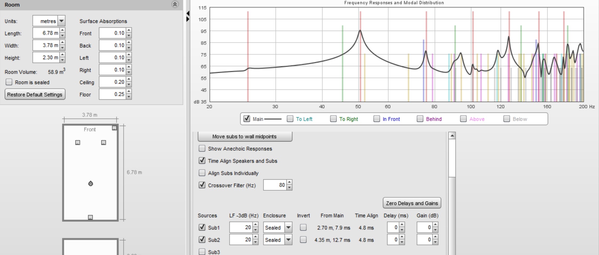

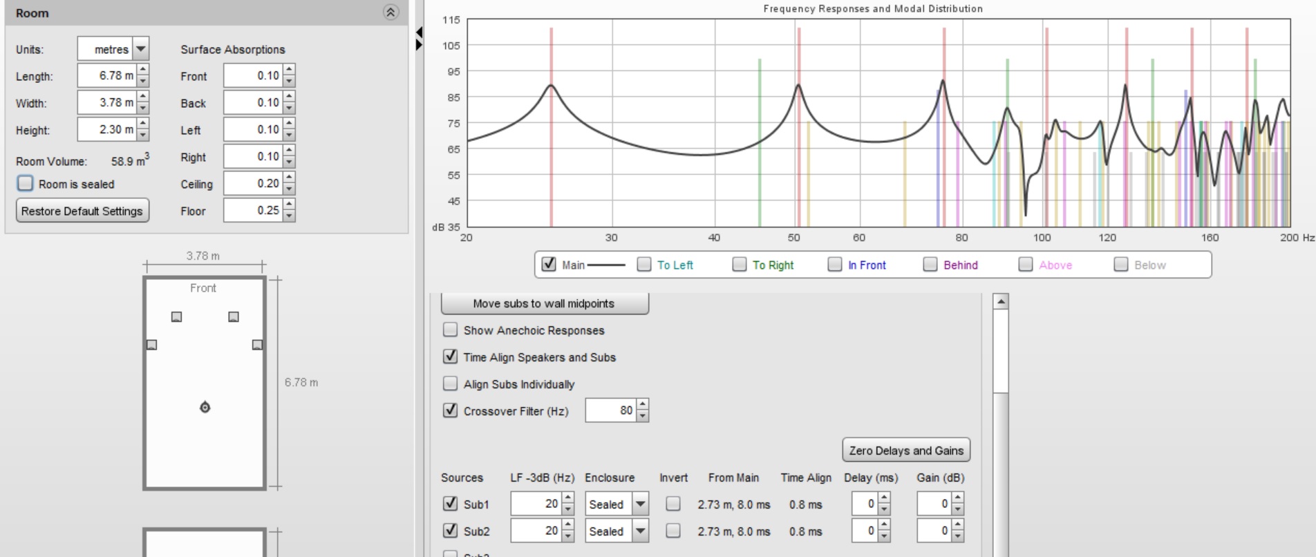

Makes a ton of sense. I have looked at REW and will likely start testing with that tool. What is your experience with the Room Simulator in that tool? Because when I use that to move subs around it looks quite terrible :)
WaynePflughaupt
WaynePflughaupt
I've never used that feature. It's mainly telling you what frequencies you can expect to see a peak or null in response given a specific location you have the sub in. The middle graph looks pretty good in that regard, might be showing a viable location.
However, calculators like that work best if you have a perfectly symmetrical "shoebox" room. That "hole" you have in the floor near the window corner, or door openings that can't be closed with a door, etc. will screw it up, as will things like vaulted or cathedral ceilings.
