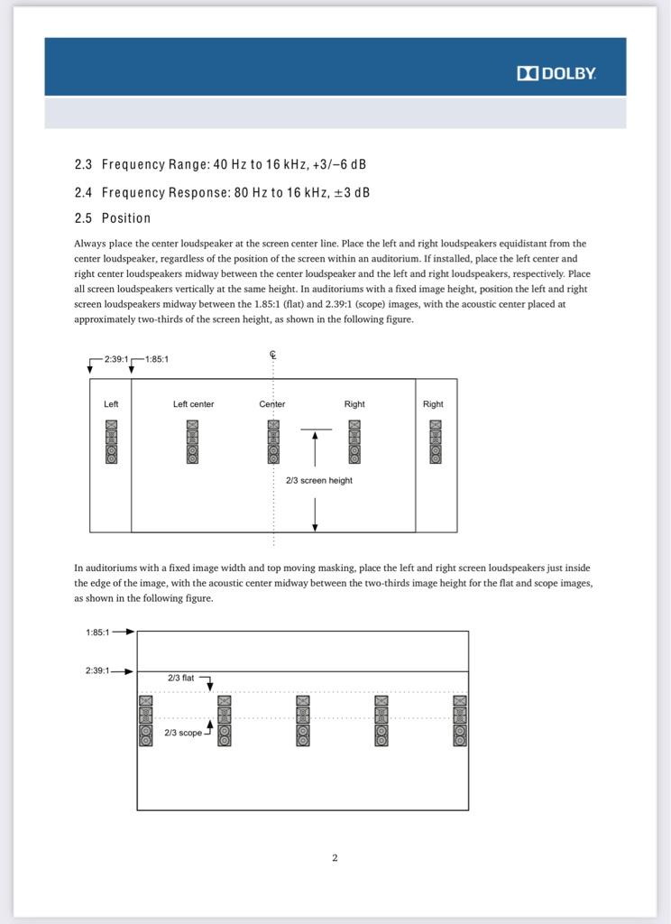

Hi All,
One of my friends wants 9.1.4 set up. Some one suggested him to keep 3 center speakers ( left center , center and right center ) along with left and right speakers on front , which makes it total 5 speakers in front stage , is it possible, if yes, which AVR or processor will support this, please advice

That sounds like SDDS - Sony’s COMMERCIAL Theater surround sound system.
But no HOME CONSUMER processor/AVR has SDDS.

Depends on how wide the room is imo. Most narrow living room spaces get good enough coverage with normal LCR placement, and in some cases front wides are pretty effective. FW get used DTSx pro, and sometimes supported by Atmos.
Left and right centers are supported in Atmos but normally implemented in commercial cinemas. Iirc trinnov, and JBL offer processors that support L and R centers but I’d have to take another look to make sure.
Do your friend say why he was told he should implement L and r centers? Unless this will be a large dedicated home cinema, I don’t really think it would be necessary.

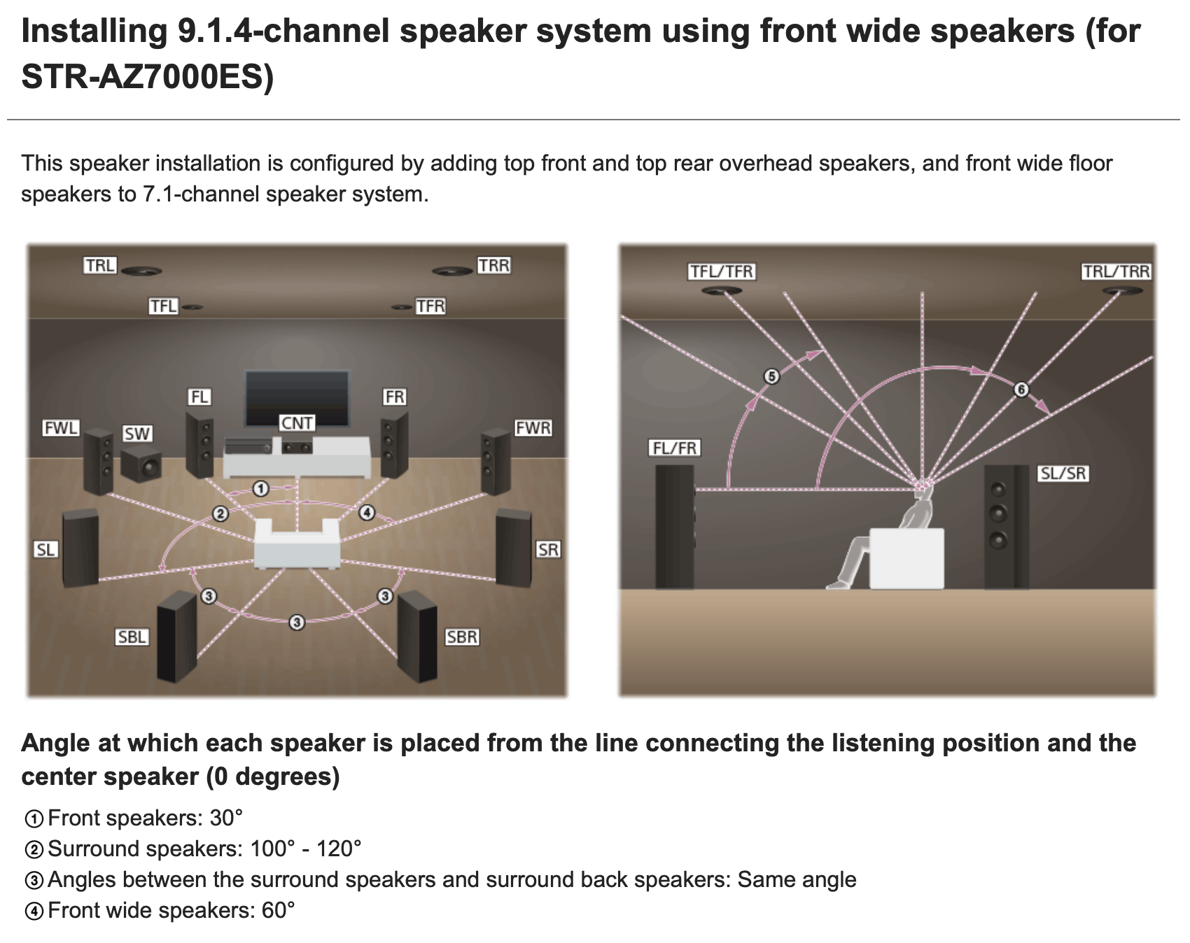

I was stuck on the use of three center channel speakers. A pro setup would have five matching speakers up front. Most in home will have two pairs of matching fronts and a center channel for a configuration consisting of front wides. Support for front wides is still out there and is supported in the new Sony receivers as well. Haven't come across anybody claiming to use the 360 RA 5.1.5.3 configuration, yet.

I was stuck on the use of three center channel speakers. A pro setup would have five matching speakers up front. Most in home will have two pairs of matching fronts and a center channel for a configuration consisting of front wides. Support for front wides is still out there and is supported in the new Sony receivers as well. Haven't come across anybody claiming to use the 360 RA 5.1.5.3 configuration, yet.View attachment 64555

Hmm, so Atmos can do 3 front Centers like SDDS.
"A minimum of three screen loudspeakers is required. For a screen wider than 12 meters (approximately 40 feet), we recommend the addition of left center and right center loudspeakers."
