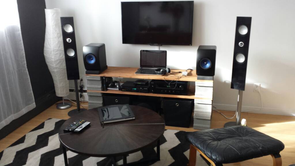

Hi guys,
I have around $700 cdn to spend to upgrade my system. I was about to order a SVS SB1000 but before doing so I wanted to know what you think would bring more bang for $$$ between these 3 options:
-Yamaha sub to SVS sb1000
- Onkyo tx8020(50w/ch) to Yamaha A S501 (85w/ch)
- Speakers stands for better placement, carpet, etc.
More info:
System: Flac files - Ibasso d7 dac - Onkyo tx8020 - Kef ls50 - Yamaha yst sw012 sub.
Room: about 12 x18 x 8, speakers sit on top of a DIY AV shelf (24") (made of cinder blocks and pine) about 5' apart and 1' from the back wall. Sitting position about 7' from the speakers. Hard floor (no carpet)
Many thanks
Envoyé de mon SGH-I337M en utilisant Tapatalk
I myself would upgrade sub first, then speaker positioning / room acoustics and amp last. First two really depends on your room tho, if it is really bad then that first.
The sub will provide the most improvement.
I'd suggest getting both the subwoofer & speaker stands, forgo the amplification upgrade.
If i can find good "cheap" stands that fit the LS50 I could go this route.

Added a rug to the setup and there is an audible improvement ... quite happy with this $70 cdn investment
Holding up on the sub upgrade since SVS recommended the sb2000 over the sb1000 for my setup .... might go with this or the L12 in a month or two.
