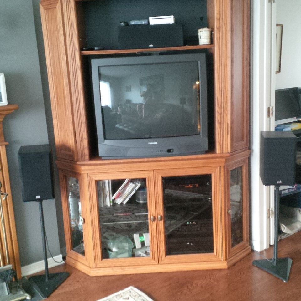

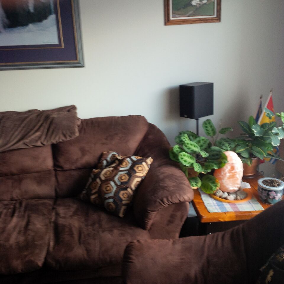

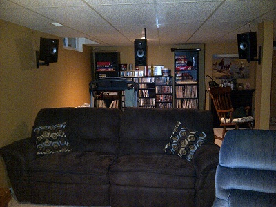

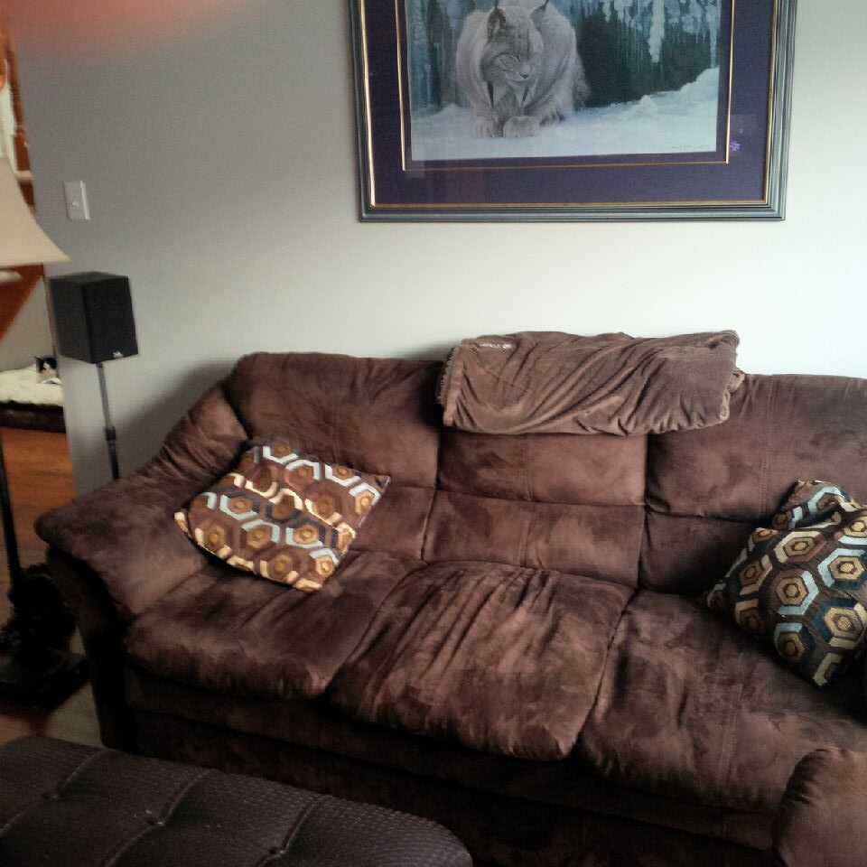

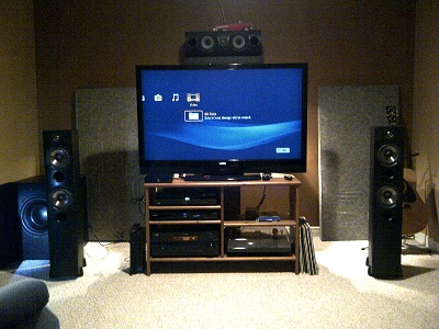

The PSBs are equally good for music and HT. Check out my two systems based on PSB . I've had the T45s since 2005 and have not felt the need to upgrade..
IMG-20130924-00098.jpg IMG-20130924-00093.jpg IMG_20150414_080823.jpg IMG_20150414_080932.jpg IMG_20150414_080926.jpg
