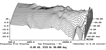

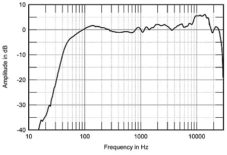

Polk Audio speakers are mediocre to poor designs at best. Couldn't find any data on your specific models above, but these from another thread (closed:confused:) demonstrate exactly why:
Poor off axis performance (demonstrably audible) and a rising treble (also demonstrably audible). I suppose if you are older, with lots of HF hearing loss, younger but deafened by over exposure to high SPLs, or just plain like sizzling HF coloration (which is why you must take internet subjective tastes with a grain of salt...and realize how irrelevant they can be to what you will hear/like), then something like those may fit your tastes.
It's possible to get good sound (measurable/verifiable via controlled tests) for your budget. The aforementioned Behringers are a nice choice, as are speakers available right here on the forum, which may closer match your original propositions:

Measured/reviewed here

wow, you guys love your charts.

I would really like to know what speaker that graph is a measurement of. It very possibly will hold no water when discussing the 70's in particular. As best we can lets have a fact and evidence based discussion.
Because we comprehend them.
while not bad, to say it is some leaps and bounds better choice is a bit of a stretch, but again this is subjective.
No it isn't. It isn't subjective to comprehend that the on axis frequency response is much more linear, it's objective. It isn't subjective to comprehend that the off axis frequency response is much more linear, it's objective. It isn't subjective to recognize that human can hear and prefer frequency linearity over non-linearity, it's objective.
to me, the Infinity primus line is "meh" at best.
That, is subjective. Due to a lack of objectivity. It should be taken for what it's worth.
