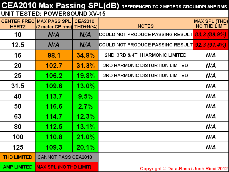

Audioholics Five-0
I was about to Pull the tigger on the svs pb12 nsd because I just hear so much about how good the sound quality is but I also am thinking about the xv15 because its a larger driver and power...
The PB12-NSD is a fine sub no doubt, but in your case where you want to squeeze as much output as possible for your money, the XV-15 has a big advantage:
I XV15 CEA2010 CHART.PNG Full Screen Image — Reviews and News from Audioholics
PB12-NSD CEA2010 CHART.PNG Full Screen Image — Reviews and News from Audioholics
From 32Hz-80Hz, the PSA holds an average of a 6dB output edge over the SVS, which equates to a 2-1 advantage.

Wow a 2-1 advantage on dbs? Well I'd say the xv15 will be the one for me :) thanks Steve
