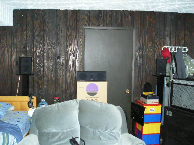

I just set up my rear center a couple days ago.
You want the rear center to be the same height as the surrounds, and you want the surrounds a couple feet MAX above you(but never below).
Heres a pic. The seat on the right of the couch is the centered seat. Thats how it should be setup.
