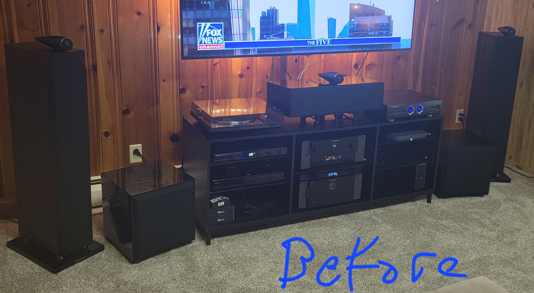

I have a fairly small listening space for my av room, about 9' by 12'. 5.2.2 configuration. I keep moving things around based on what I've seen in av forums. Is the "now" vs "before" configuration the best for my space? [Subs in the corners]

What's your viewing distance? Distance to center will do.
You want 30 degrees for the fronts and if you're sitting at a distance chances are the wider placement is more appropriate.
philly
From my sweet spot, it's about 7.5ft to the center speaker, 8.5ft to the floors, and 9ft to the tv.
Thoughts?
W
Wardog555
So that looks to be 8.66 feet apart for the front speakers to hit the right angle of 30 degrees.
Or go as wide as you can if you don't reach that spacing.
philly
So the current configuration is ideal?

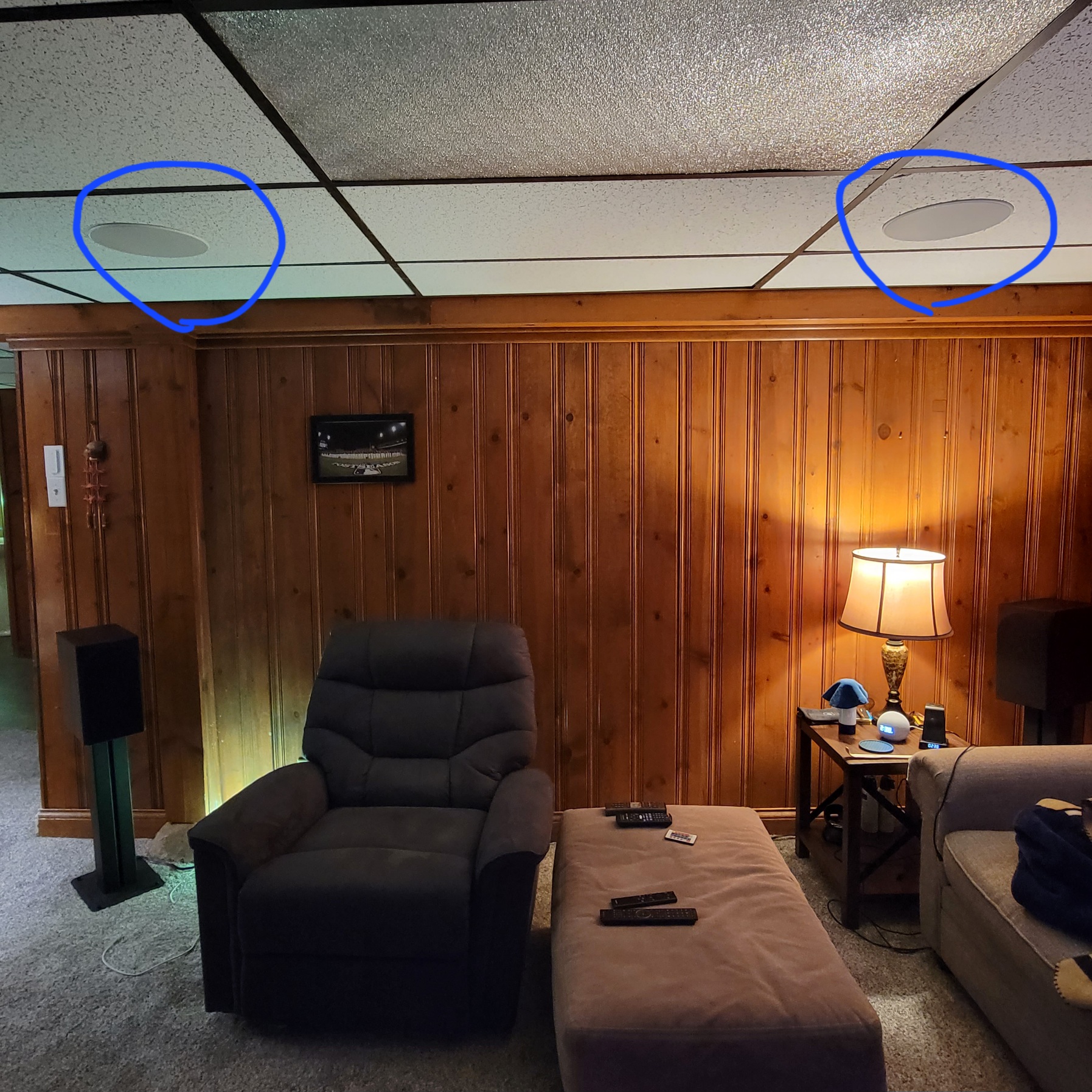

Where are the ceiling and surround speakers? Up front was best for both subs?
philly
The ceilings are about 4.5ft from the seating and 6ft apart. You can see the placement of the surrounds here. However, I'll be moving the chairs a little when I get the 2nd one this week. And thanks for the update on the subs!
Btw I just measured and the fronts are about 7.5ft apart, if that helps

The answer is "it depends". You can't go on visuals alone. The newer setup makes sense as the best placement to start with subwoofers is in the corners or the 1/4 or 1/2 point along a wall. This is where it helps to have a measurement microphone and Room EQ Wizard (REW) software. You can't reliably rely on your memory as to what is better when it comes to sub placement but measurements will tell you if you have any room modes to contend with.
What works best for the towers depends on the speaker and personal preference. With the towers in the corners you will get more reflected sound. That can work well with a speaker that has a very linear response in the horizontal plane. If the response changes off axis, moving the towers in or changing the toe-in can address that. Without measurements I would concentrate on the bass and vocals. You want the bass to be smooth and even, not boomy or resonant at certain frequencies. If the towers and center are positioned well the intelligibility of dialogue should be at its best.
