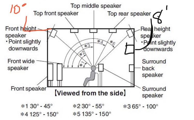

@Holmz , the first area to concentrate on is the 5 "bed" level speakers and TV position. Place them all so the tweeters are at ear level as is the center of the TV screen. (In the photo the Front L&R speakers appear too low, and the TV is too high) …
Good luck with your install.
Yeah:
  • The TV is moving to be under the window on a cabinet with a lift.
  • The surrounds have brackets to mount them on the wall higher up, so they are on floor just during this initial layout.
The op is confusing us. Atmos is ceiling height only.
Not intentionally.
I am confused myself.
I guess it is an Auro AVP then.
Except don’t forget that front and rear heights are supported.
^That^ picture is helpful sir.
