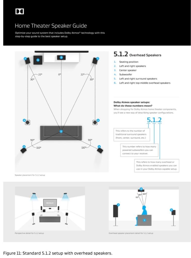

Your room is dictating a 5.2.2 as it's not possible to fit in another pair of Atmos speakers behind your primary seating position with the configuration you suggested. (5.2.x - the x is how many Atmos speakers) If you can pull the couch away from the wall two => or preferably three feet, then you could get to 5.2.4 but the WAF may come down on you for that. (Suggest putting casters under the couch and move it back and forth as you please?) Of course you can add more of your subs to the mix but do the sub-woofer crawl to figure out where the first two should go, then configure and listen to them with your 5 bed level speakers to see if you need / want more.
Here's a set up I laid out for a member in a similar room. He already had all the speakers except the Atmos in ceiling ones.

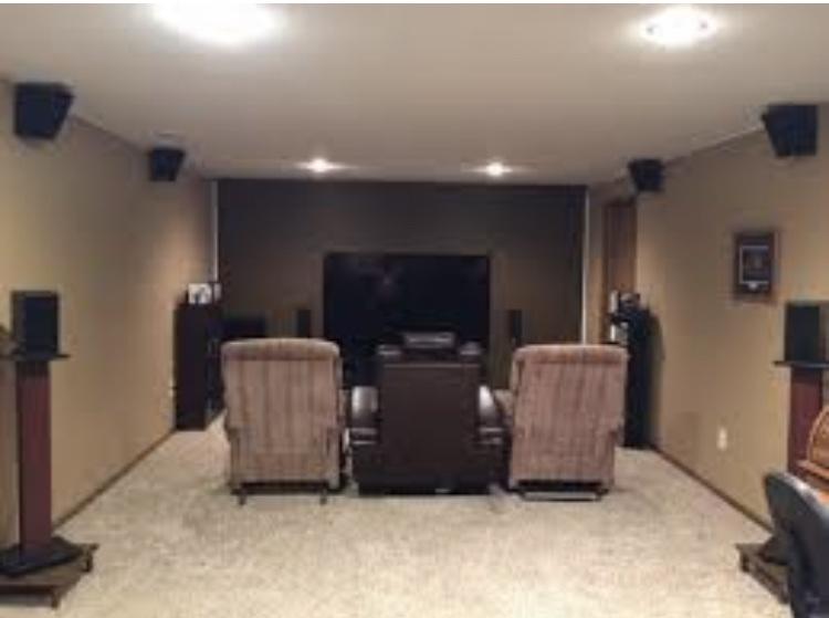

@Holmz , the first area to concentrate on is the 5 "bed" level speakers and TV position. Place them all so the tweeters are at ear level as is the center of the TV screen. (In the photo the Front L&R speakers appear too low, and the TV is too high) There are allowable tolerances in Dolby Atmos® Home Theater Installation Guidelines. Then do a Subwoofer crawl to determine those positions. Once you've negotiated final seating arrangements (WAF) then I'd look for the locations for the Atmos speakers that fit the Dolby recommended specs.
As per @William Lemmerhirt with only a single Atmos pair you will lose front to rear overhead panning, which is why folks install 4 in the first place. But if you can't place a pair behind you, you won't hear it anyway so the point is moot.

I've attached the angles for 4 atmos.
I'll vote for 4 atmos on the condition you are away from back wall.
