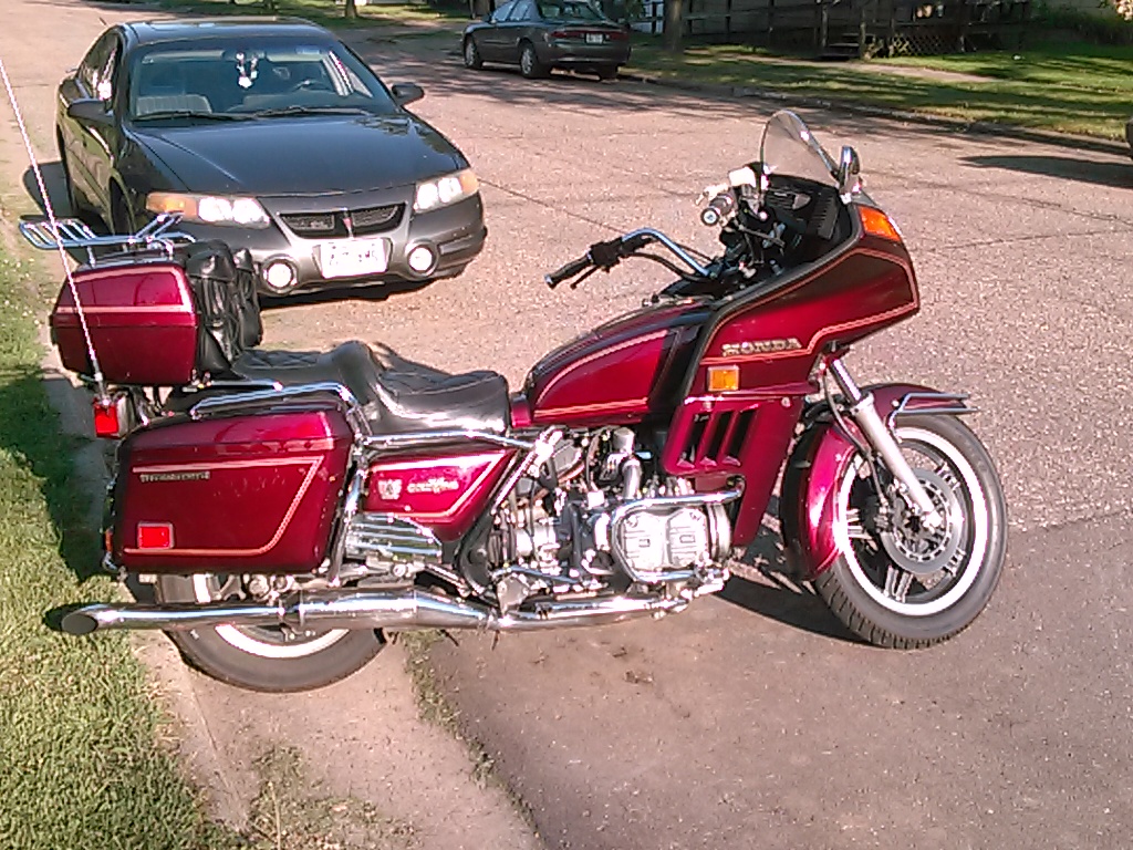

Post a photo of the bike- if the faring has enough space, you might be able to make a fiberglass enclosure for the speakers or some kind of pod- that can help.

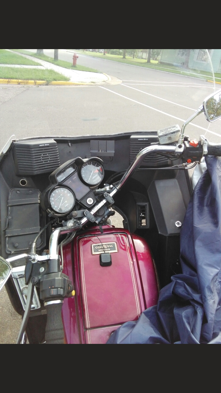

I was hoping for a shot from behind, so I could see where the speakers are. IIRC, they're a the top of the fairing, with a soft vinyl cover over a storage pocket, am I right? If it has a flat area (or even if it's not totally flat, it needs to be about 5" wide), you could make a panel to cover the storage pockets. Any small speaker should receive limited low frequency range.
Think this is what you wanted.
If you remove the speaker pods, you may find that you can fit 5-1/4" speakers by making a new mount. Check the Honda/Gold Wind forums for ideas.
Regardless, you'll need to limit the bass if you want loud and cleaner than what you're getting now. Electronically, you can do this with a non-polarized cap, about 400uF. If you can't find a 400uF cap, two 200uF caps wired parallel will work.
