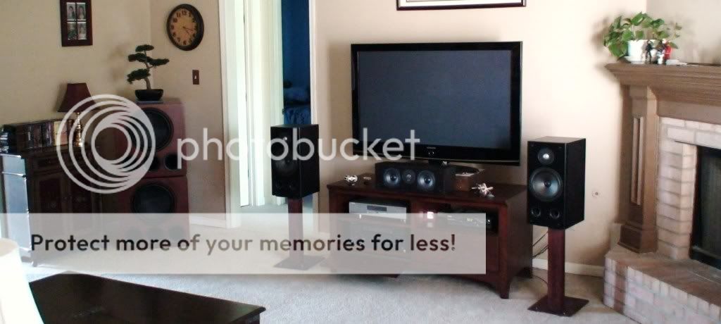

Totally agree. You'll get more speaker for that budget in a bookshelf and some stands. Example:
You can never have too much subwoofer :D
Whoa nice stacked PB13's. What speakers are those?

Don't hate me, I only have one Ultra, that picture belongs to croseiv! Thats his system at his house. You'll have to ask him what his mains are.
