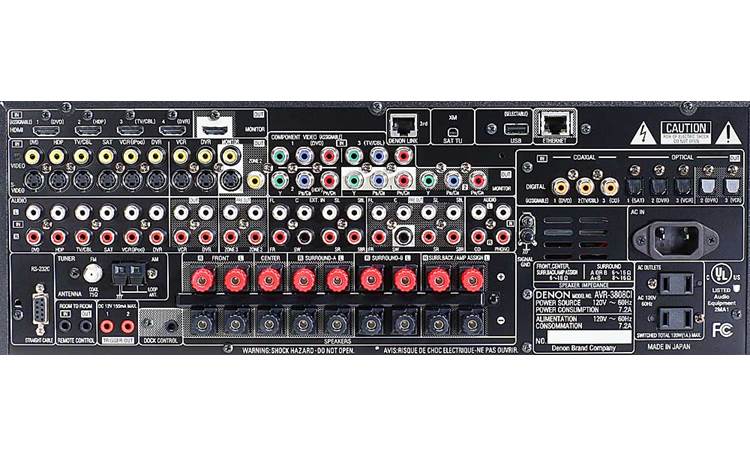

Yes you can as the Denon avr3803ci receiver has pre-outs. But why not try using the Denon on it's own first?

The AVR-3803CI is a bit different than the AVR-3803.

This is SoundAndVisio testing the amp on AVR-3808CI. They did test only at 8ohms, but the amp performance shows massive resources.
This graph shows that the AVR-3808CI’s left channel, from CD input to speaker output with two channels driving 8-ohm loads, reaches 0.1 percent distortion at 186.7 watts and 1 percent distortion at 210.9 watts. Into 4 ohms, the amplifier reaches 0.1 percent distortion at 238.9 watts and 1 percent distortion at 277.3 watts.
So, 3808CI has a great (for a receiver) amp and it is absolutely rated to work with 4ohm loads:
Dynamic power: 210 W x 2ch (4 Ω/ohms)

3808 is more powerful than the 3803 the OP has, tho. Not that something like TLS' Quad 909's specs per Quad are all that impressive either....

I can understand the confusion with the 3803CI vs 3808. If you search on 3803CI Google pops up a bunch of 3808 articles. Very little info out there on the 3803CI. If you add "-AVR-3808CI" then Google filters out the 3808 links (the minus in front acts as a "not"). Very few links returned with that filter.
