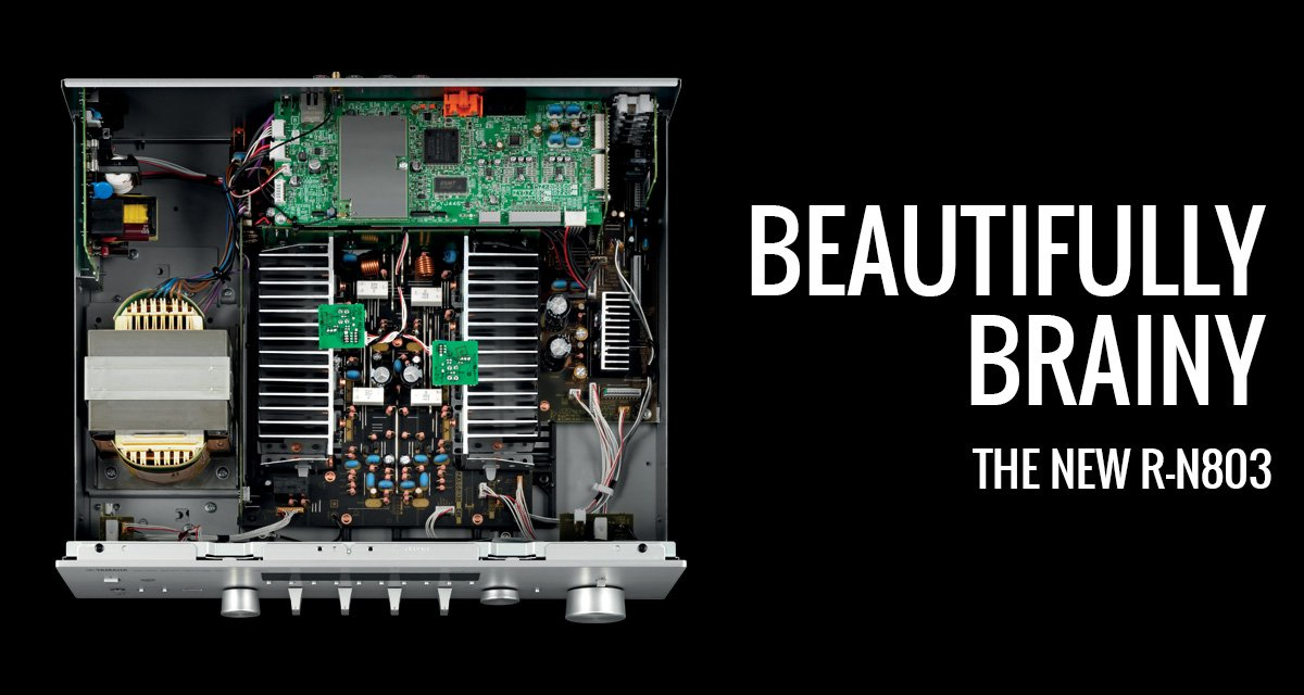

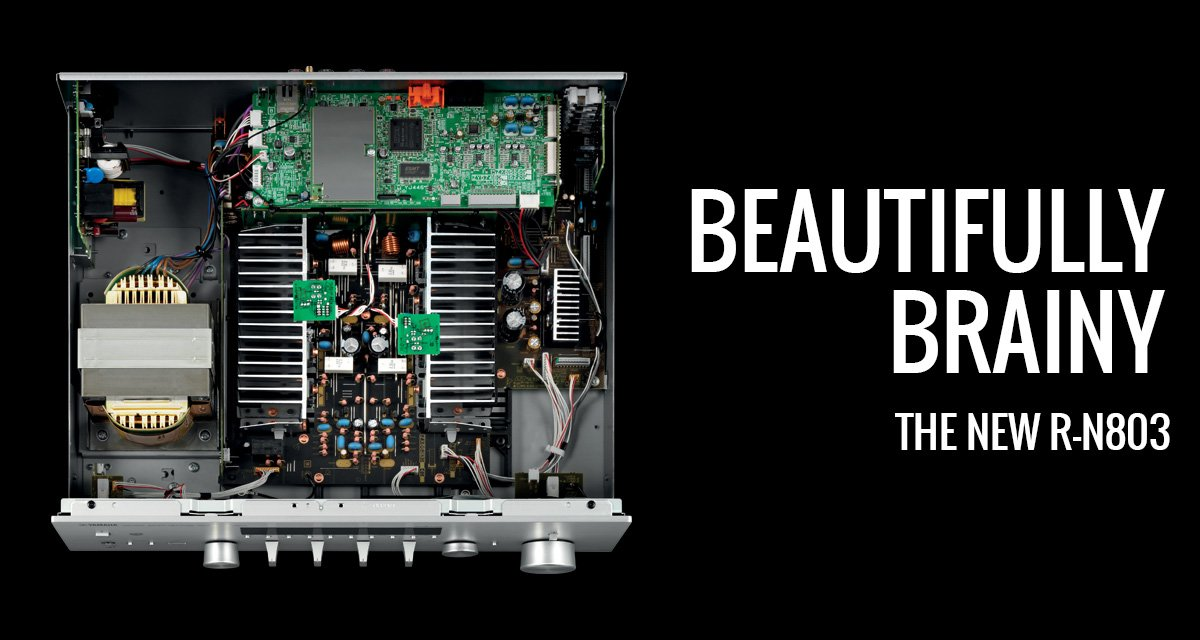

I agree the best value would be an older AVR such as a RX-A1080, AVR-X3500H or even the AVR-X3400H. For 2 channel receiver, I am quite impressed with the R-N802. That thing should be sonically equivalent to a so called integrated amp A-S801, but have overall more useful features.
Indeed, it even has subwoofer out, room EQ, tone controls and loudness.
